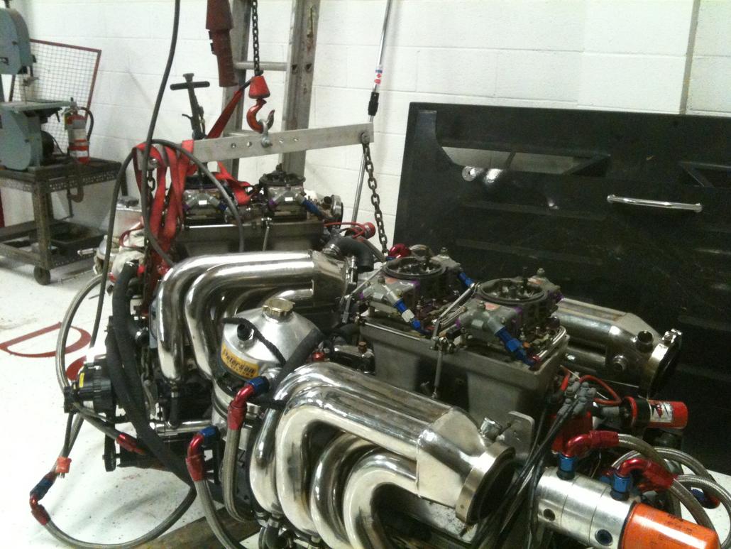

Pulled the mill's out of the 33 last week,time to tame them down a bit

Bingo less wrenching more boating,we have some very fast boats in the fleet that are much easier to service so this one I'm going to slow down to 120's

What a great year so far,I finally found time to work on this thing we chilled the cams a little bit and went to single 1050 doms on a sonnys bb5 intake and so far its working out good we ran 122 mph at 5700 (five on board and full tanks light water)I would like to try some 16/1/2 by 32 five blades (#6) drives...spinnin 36 fours now

We put the 17/1/2 26 five blades on tonight just for fun .... the thing is a drag boat what a blast its all done at 108/6200 but still a lott of fun........out
