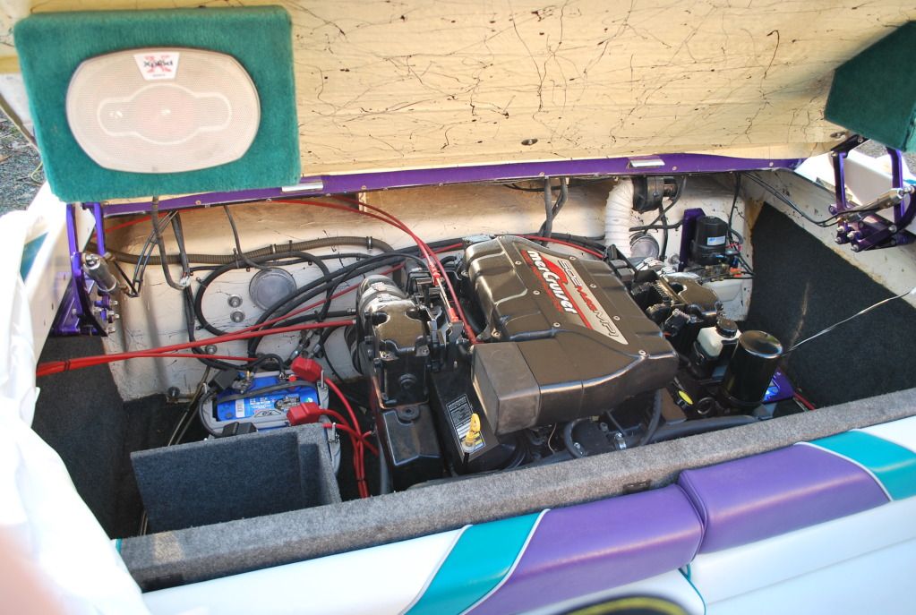

want to put a second electric ram on engine hatch
Joined: Jan 2013
Posts: 50
From: Dayton, Ohio
My 04 daytona has an electric engine hatch but with the ram only on one side it leaves the other side free. It will catch the wind and raise up significantly at high speeds. It has a strap to snap it down but still lets it move around quite a bit. So does anyone know where i can get another electric ram to put on the other side so i don't have to worry about losing my engine hatch, especially while towing!

This is true, and can be a problem. I went through the same thing with my rig. To be honest, it was a big pita, and expensive.
If your going to install dual rams, get the "dual hatch actuator accelerator". Essentially, it is a relay box that you mount in the engine compartment, somewhat close the the batteries. When this is used, there is little to no voltage drop to each actuator, so timing stays closer. The actual control switch in the helm is only used to activate the relays, and no longer has the running current going through the switch.
Secondly, purchase the hatch actuator stop collars. Using these does two things. One it prohibits over contraction and ripping your mounts out of the hatch. Secondly it will keep the actuators in time once the hatch closes and each actuator hits the stops and slips the clutch.
Also, the actuators that are for sale have the ability to life huge weight, something like 500lbs. So double check that your stop collars are actually stoping the ram and making the clutch slip. I had to double up the collars on one of my actuators, just due to variences of the clutch slip torque.
One last thing, I abandoned the original floor mounting of the actuator. It was making the honeycomb floor weak and soft, and the holes were getting egged out. I ended up mounting both rams to the transom on each side of the motor. Used a couple of color matched stringer washers on the outside with stainless hardware and sealed well. Being that the rams are only lifting 1/5 or less of it's capable limit, the mechanical disadvantage of the mounting angle is negligible. That being said, it would still be best, to have the actuators mounted to a solid floor, and pusing up on the hatch, vs pushing more out that up when mounted to the transom.

Thanks for all the ideas! I think i might machine up an aluminum bracket to go in place of the cheap snap setup it has now. Something simple an good looking that i can just put a pin through when its closed. The Dana hinges are to pricey and I don't think they'll work on my setup. And an additional ram sounds potentially troublesome and also kind of expensive.
