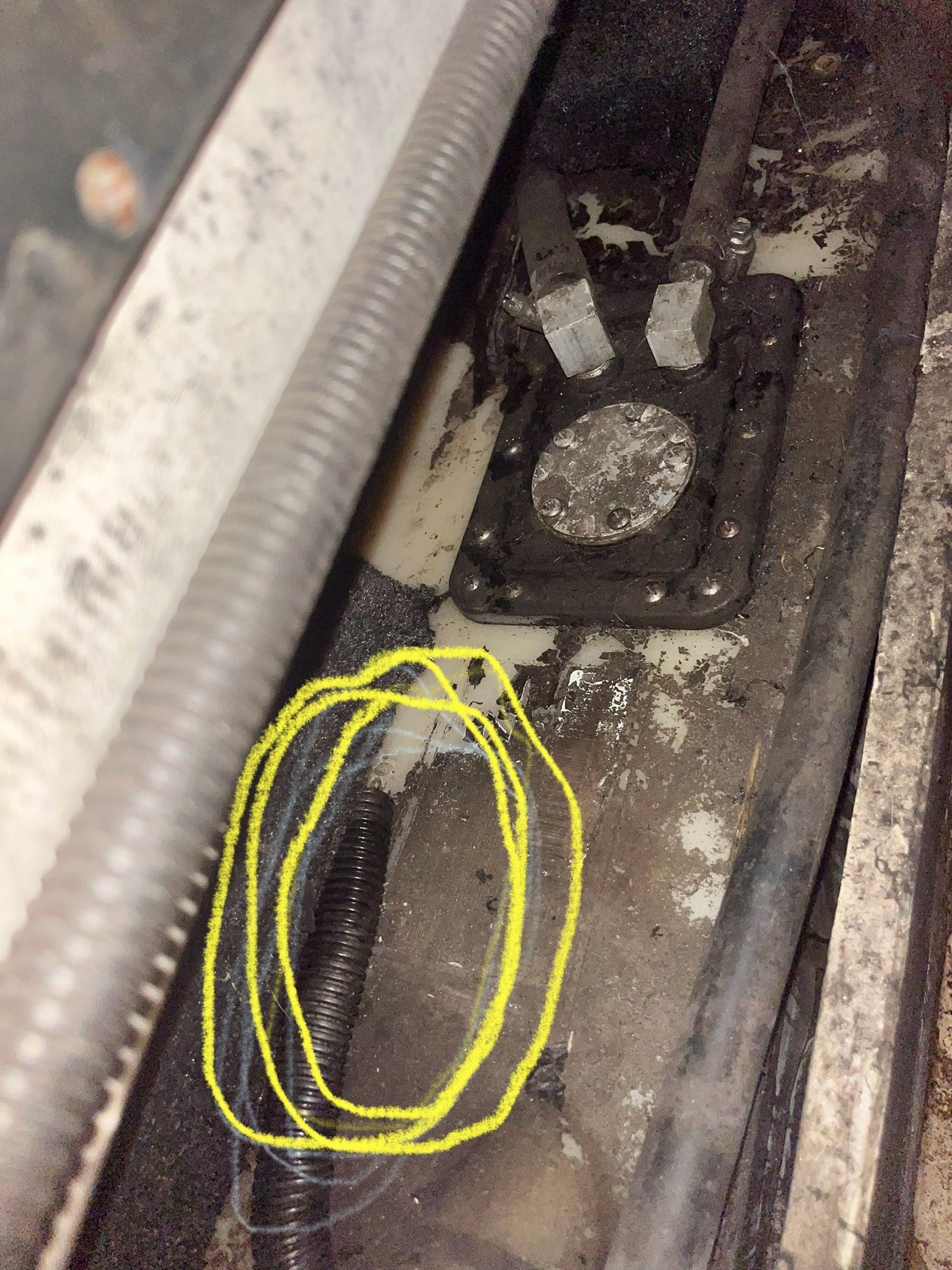

[img alt="Usually the round metal thing by the hoses would be the sending unit but theres no wires going to it???? The dissapear under the deck and there are no more access panels anywhere, where do i find this dang fuel float, better yet how would one replace the fuel tank????…..but seriously i need to find the fuel floater so i can test it and get my gauge working that way we are back 100%
Thanks in advance"]https://cimg1.ibsrv.net/gimg/www.offshoreonly.com-vbulletin/1500x2000/img_1889_ce4aa33e7e6d874ea9ff166843bd685e8de4d646. jpeg[/img]
Usually the round metal thing by the hoses would be the sending unit but theres no wires going to it???? The dissapear under the deck and there are no more access panels anywhere, where do i find this dang fuel float, better yet how would one replace the fuel tank????…..but seriously i need to find the fuel floater so i can test it and get my gauge working that way we are back 100% Thanks in advance
