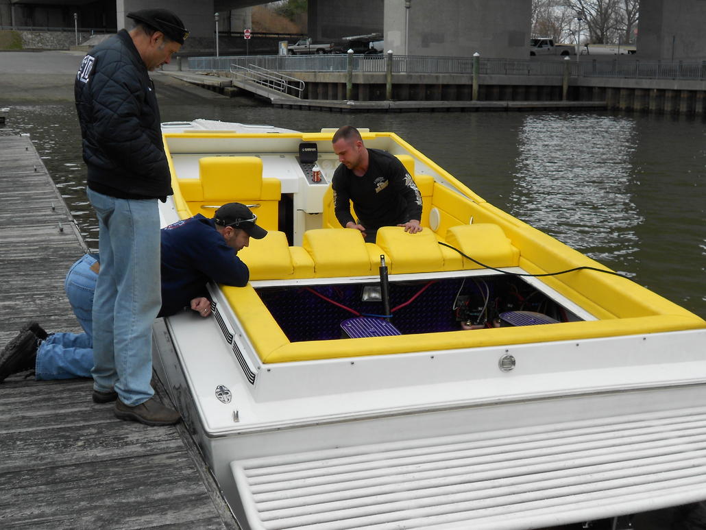

well heres a note to anyone putting a boat back together : make 100% sure all suction hoses to the sea pump are tight and leak free!!!!!! gasket at water inlet cost me 2 impellers and housings ! oh well !
