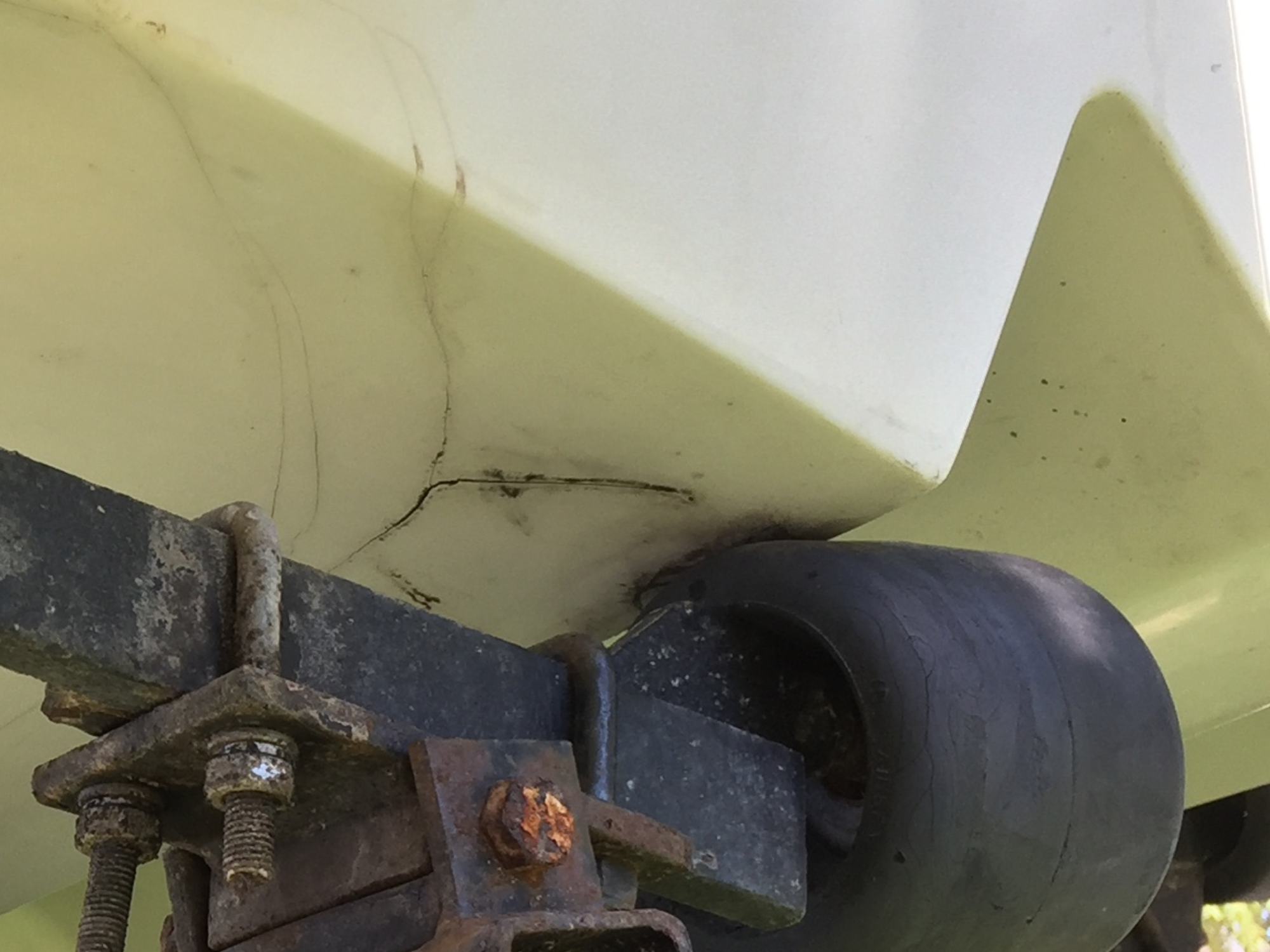

Gonna be a bit hard to answer but what do you guys think of this?
It’s below the transom on an older 19’ outboard ski boat, full project, will likely need new floor and transom. I’d like to think the crack isn’t too serious. I’m going by the photo alone, won’t get to see the boat.
Any thoughts appreciated.

RR, I cant comment on the cracks your asking about. But I would certainty have some concern with the big oval hole in the transom.

That's a very strange crack especially considering it's in a part of the boat that is very tough. And to add to it , it doesn't seem to have taken a whack or hit anything as there's no other visible damage.
But on the bright side , if the boat needs a new floor and transom it's a small addition to the job !
edit to add : By any chance is this a cored hull ?

Seems to be pretty significant...bottom of boat and up the transom. Certainly more than just a gelcoat crack I think. That roller trailer hasn't helped, probably...
But yeah, everything is 'fixable'. Just depends on if it's worth it.

I'm no glass expert but that looks pretty dam serious to me. It's amazing what salt water does to a trailer too!

Thank you all for the replies.
That oval shaped hole is for the notch ventilation. There’s another one on the bottom of the notch, I think they’re connected.

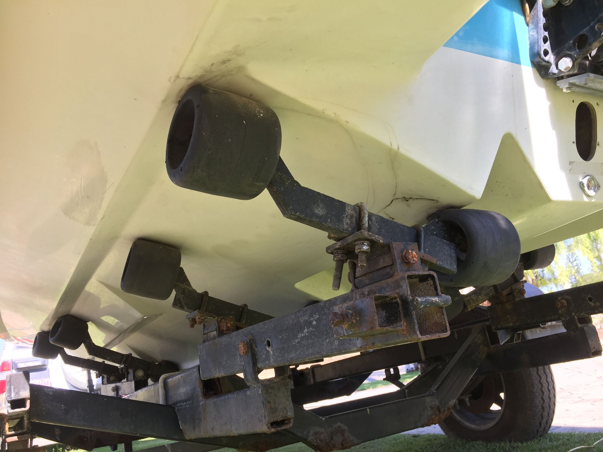

There’s another crack on the inside, I’m waiting on pics. Trailer is in poor shape, maybe repairable, maybe junk.

Rak, my guess is that that damn roller near the crack caused it on a rough road or something similar. Should be repairable. Bob.

I would have to agree, it appears the crack was caused by the trailer. Since you would be putting in a new transom, floor and maybe repair of some stringers I would not let it bother me. You will have access to the inside and will be able to reinforce this area equal on both sides. Use it as a bargaining point.
