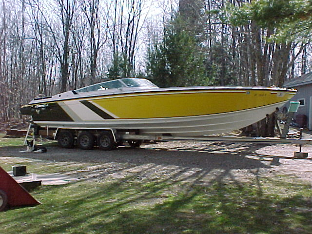

Well, Outlaw and I had been exchanging some info Re: locating the axles on my trailer & info on my tow vehicle. In that thread I had been discussing that I intended to rebuild the engines' on our 311 and now my son and I were able to remove the arch, we were able to squeeze the boat into our garage.

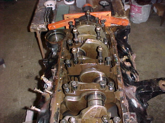

So, after setting the engine on the concrete and wood blocks, we unhooked the rear chains, removed the bell-housing, flywheel etc. and hooked the chain-falls back so we could finally attach the block to the engine stand. We rolled the engine into the back bay and began the tear down. Since the exhaust, intake and heads were removed, prior to engine extraction, there was only the oil pan, harmonic balancer, timing cover, cam, cam chain, pistons/rods and crank to pull. It seemed like we were on easy street and that we would have that all done in a couple of hours. So our first problem was removal of the harmonic balancer. I have a nice puller,
it would not budge. I had to heat it up pretty good until it finally came. I ran into several external bolts here and there,
such as: the timing cover, motor mounts etc. I have a penetrating oil called KROIL... This stuff is magic... I think it works better than PB blaster, and PB blaster is good stuff...
Anyway, we now have the engine completely torn down and
and I have some decisions ( not Quikdecisions) to make.
I was hoping to not have to bore the engine nor purchase new pistons... ( taste for liquor and pocketbook for beer ) The bores do not look all that bad, but I do not yet have the equipment to measure the piston to cylinder wall clearances.
I know that since these are forged pistons, they grow once warmed up. If I use a feeler gage, there is definitely more clearance opposite the wrist pins. This suggests an egg or elliptical wear pattern. Likely, I will have to have the block bored... And thus... the second engine, not yet pulled out, will also have to be bored. We have approx 670 hrs on the engines. I solicit all suggestions / advice as to what I should do. I plan to thoroughly clean the block, esp the water jacket.
Next step will be to go to the machine shop for boiling, cam bearings and frost plug replacement... I will solicit their advice on how to proceed as well.
