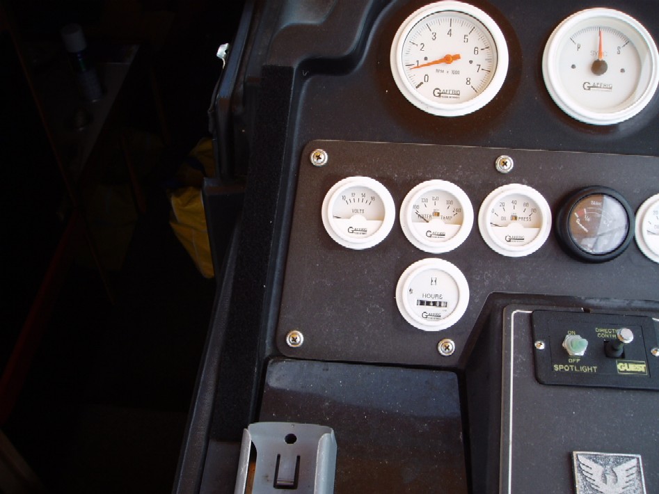

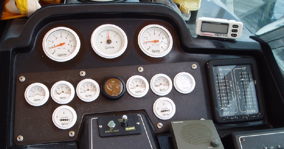

Here's a picture of dash in older SR357 with Livorsi/Gaffrig guages. At this point I was still trying to make the VDO sender work with the Gaffrig guages and it just wouldn't work so I had left the VDO in place. Also was still trying to live with the Redlines.
You can see that a new panel with the convuluted shape of dash is a pain to find an insert for,

Formula- let me know how you proceed with a dash. Now, Poorsche, is that a factory dash? I have the old "square" VDO's, so I am presuming my dash is either not going to work with new round stuff or it will be 2-tone from the elements.

I think the insert you can see outlined around all the instruments wasn't factory. The VDO's had a square trim piece around them so that area especially around tach's and synch do show the sun fade. The holes for VDO's and Gaffrigs are the same so that part wasn't a big deal. The terminals on the VDO's are slide-on connectors--the Gaffrigs are rings. It was a major exercise in frustration to cahgne all of those out because wire was old, had to clip a few of the tie-wraps to get enough pigtail to re-terminats.
Caused much swearing and drinking--but got 'er done and everythinhg worked except the fuel guage (because of sender/guage incomapitbility).
