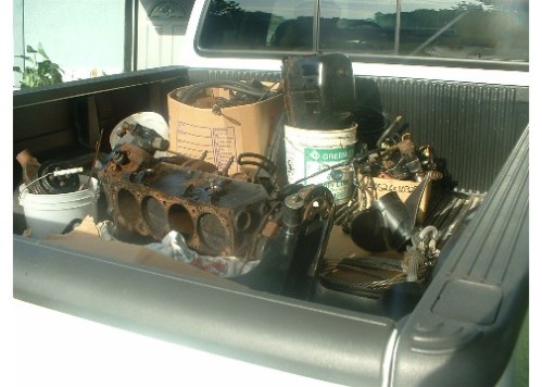

cuda's Avatar
Joined: Sep 2001
Posts: 25,191
From: Deland, Florida
Default Re: 206 Ls
You have Merc's first venture into the fuel injected engines. They did NOT work out well. I had one that was a basket case when I bought my Donzi Minx. Lot's of very good parts in the engine. Pull the engine, have the crank turned, check the rods, pistons etc, then put a high rise manifold and a q jet, or a holley on it, and you will have a helluva good engine. It's got four bolt mains, forged crank, forged pistons, heavy duty rods, and a decent cam. Good heads, with screw in studs. The FI didn't work well. I heard there was a problem with the fuel injectors squirting the fuel right on the sides of the cylinders, and wiping out the rings. While you have it apart, you might want to go with a little more radical cam, but not much. It's a damn good base to rebuild from, if it isn't wiped out. If all the parts are still usuable, it would be worth having a machine shop fix it back up.
DO NOT try to get the fuel injection working. There is a guy here on Oso that spend two years and tons of money trying to get two running in a Sonic. I sent him all the stuff I had from mine, but the last I heard, he gave up and bought two other engines.
Btw, watching a 206 run through a stiff chop that was making my teeth rattle in my fishboat is the very reason I got into this silly sport.
Here's what mine looked like when I bought it. I got it running again with a carb set up, but I made the mistake of buying some "freshly rebuilt heads" and not checking them.
