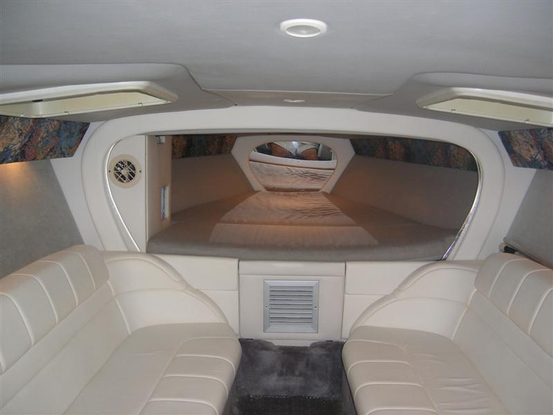

built a cabinet to house the duct work...........ran the ducting through the storage compartment and into the cabinet. Created dual air discharges, one forward, one rear......finished pics to come.

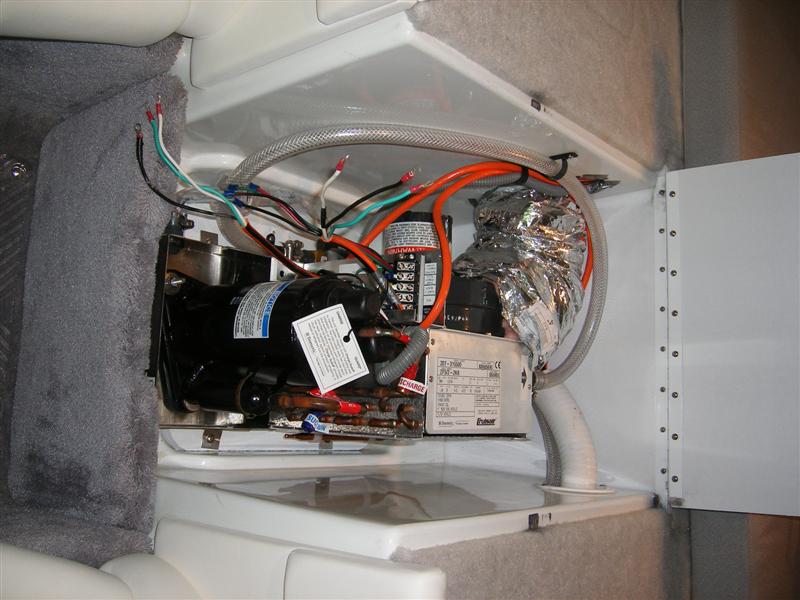

Removed the porta potti and installed a 5000 BTU Cruisair unit....plumbed the water pickup and wiring through the Heads overboard discharge hose leading to the bilge. Used the same thru hull fitting as a pick-up for the water supply. Removed the starboard bench seat in the cabin to install the AC water discharge out the side......
turn pic sideways......
Attached Thumbnails A/C in a 312 Fastech-misc20007-medium-.jpg

Created a new face panel hold the cold air return grill. Found the same fabric so everything would match.
NOTE: The factory cushion had to be altered to account for the cabinet........

Mounted the controls where we could reach them while in bed and keep the kids from hitting them when horsing around in the cabin......
Attached Thumbnails A/C in a 312 Fastech-duck060005-medium-.jpg
