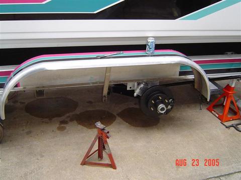

Micheal, saw your trailer question and remembered you wanted pictures of my color scheme, put a couple in, I also have similar trailer, works great but mine is very high bunked, I plan someday to lower and move forward a bit also. I have a little longer support to roller, I plan to move my winch as far forward as possible cut down roller supports and go to a pivoting bar with a carpet v above and below tie ring. the winch cable then goes between v"s I have seen several trailers set up this way and only way I can see to get mine forward after lowering it 5" at bunks. There is always something to play with We have ours put to bed for the winter so its until next year enjoy Randy
