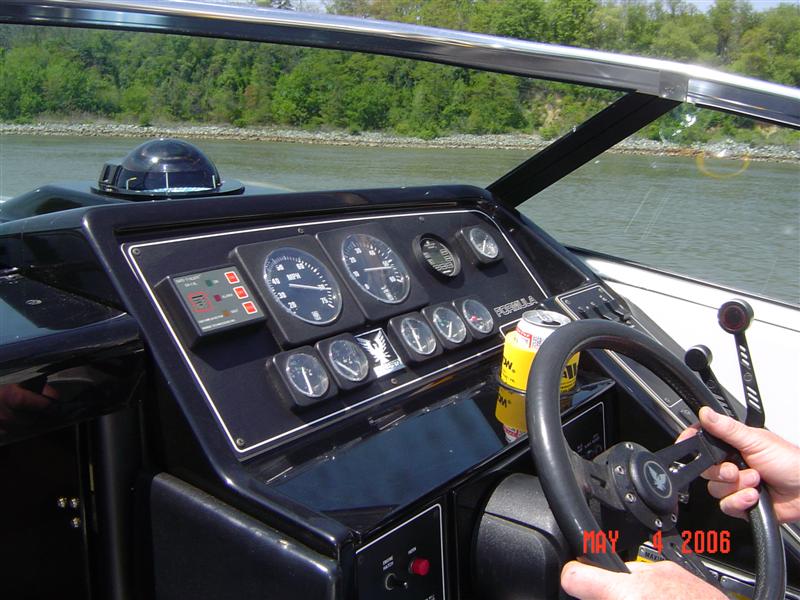

i have a 1990 242ls w/ 502/525hp at 5300rpm dynoed and runing a 22p 4blade and only reaching about 4950rpm-5000rpm at 68-69mph aand on a gooday it will kiss 70 so what prop would give me the extra rpms thanks

A friend of mine has a 91 242LS with a warmed over HP500 @ 535 HP. Turns a labbed 24 B1 5300/5400 and just about hit 70 gps , 72 speedo
