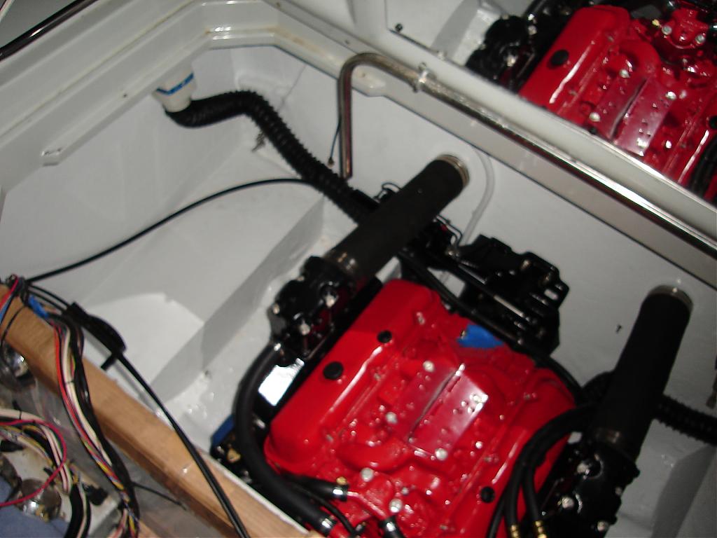

Hey all,
I am the proud owner of a 1988 242 LS which I have spent the summer painting the bilge Awlgrip White and the 454 bored .60 over and painted red with black accents.
I am now to the wiring part and here is my problem. I have dual batteries and a switch. I am assuming the two leads from the switch 1 and 2 positions go to each battery and the third lead goes to the starter? I am also confused because on the starboard bulkhead there is a piece of black lexan which has two studs above the barttery and I have no clue with this is for either. Oh the the grounds from the battaries go to the block?
Thanks for the help formula owners.
Jed

Jed, You are right 1 and 2 go to each battery the third often marked common goes to starter. The two studs were probably for a place to charge or jump the batteries if they died and kept you from opening the hatch. In that case they would be a positive and negative direct to a battery. Make sure you protect them with some form of cover if you reconnect them.
Jim

Thanks guys. Yeah I am good with wiring all the other things just concerned with getting these batteries correct. The studs I remember one being for positive and the other negative but just not sure what they were there for.
Here are some more before and after pictures of the progress.
