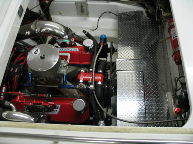

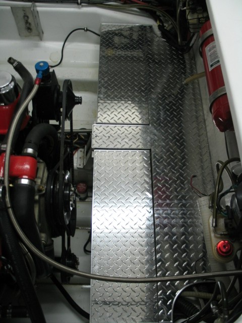

My diamond plate job from 2 years ago:

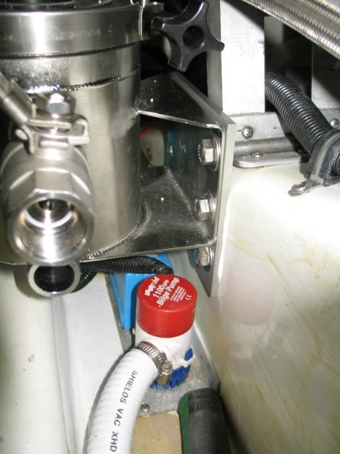

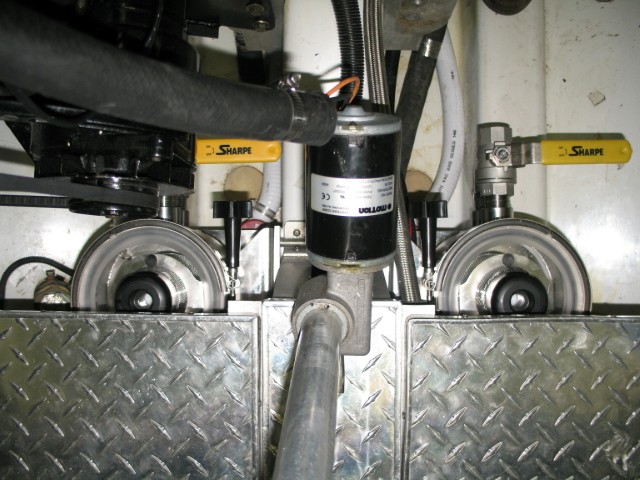

Sea strainers went in last winter:

RedDog - What did you bond your diamond plat to as a backing? It looks like you re-used the factory edging, too? I bought stainless steel valves for my strainers, too. (Strainers were already in, though...) Most of the boat's being built from the McMaster-Carr catalog.
I cut the aluminum diamond to fit the factory plywood, then just overlayed it and drilled the holes for the hinges. The factory edging helps hold it in place. I also had the diamond plate powdercoated in clear to prevent corrosion.
