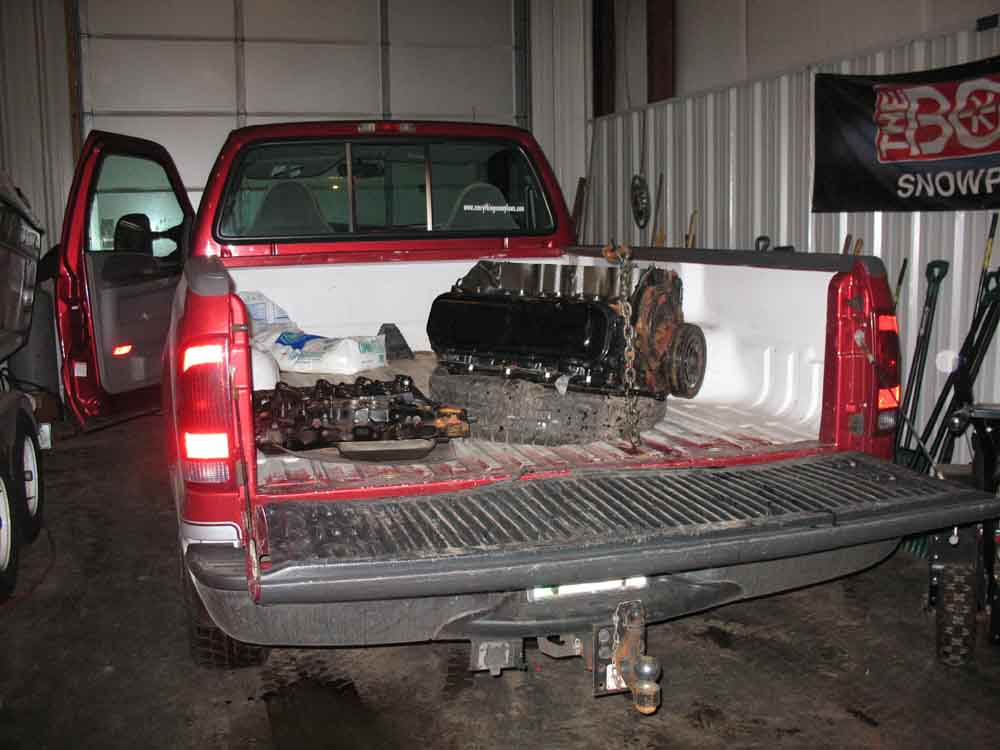

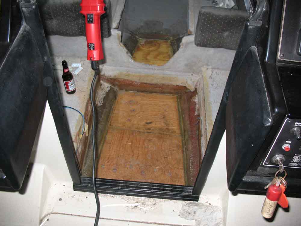

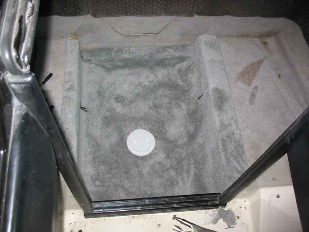

Well I've been working on my formula for a good month now so I figured give an update and some pics. The first project that was done was the crack in the hull. When we pulled up the carpet I found the floor was cracked along the sides where it was glassed. My glas man said water in there froze and thats what cracked the hull. Okay so it cut out the floor and fixed the crack inside and out and then put new wood in the floor and glassed it all in. No pics of that fix but I do have some of yesterdays carpet install and I also put a inspection hatch in just in case I need to look in there.

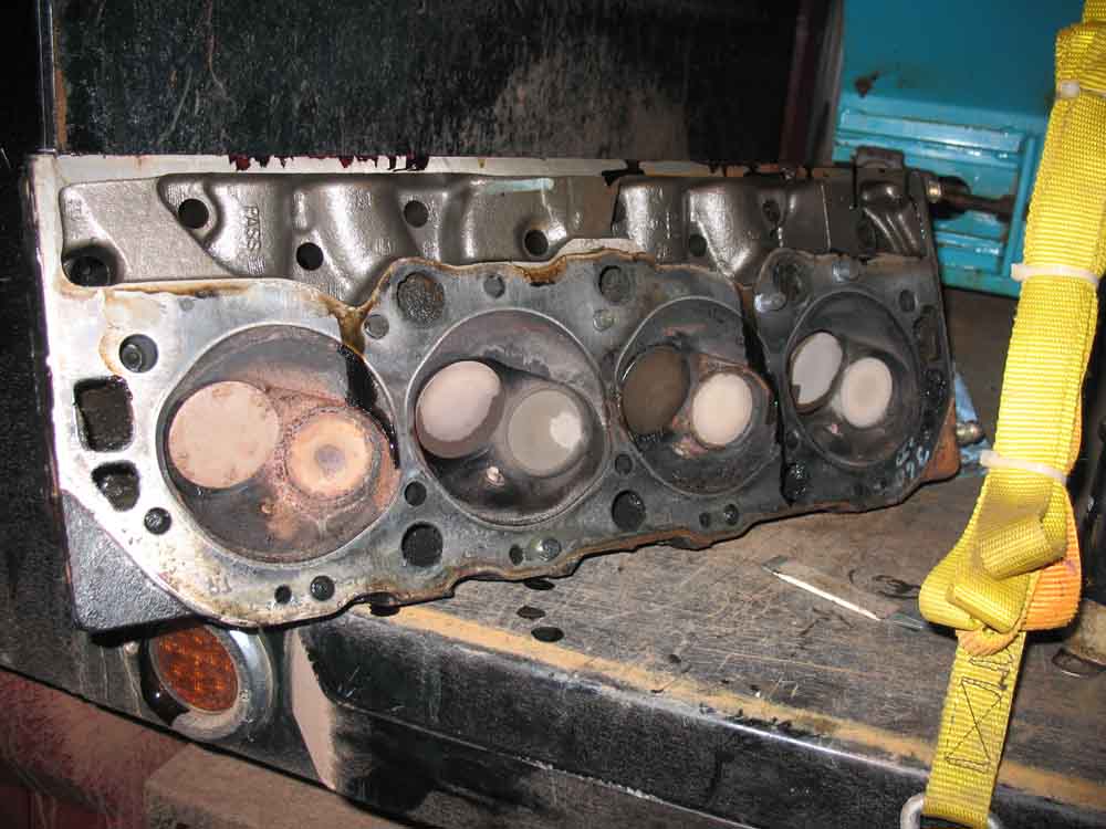

Next was thew small leak I had coming in from the transome assembly gasket, well the motors gotta come out and in doing so we found the riser gasket leaked and water went into the valves so when the motor was pulled I removed the head and the first thing I noticed was the pistons were real loose in the bores so off to the machine shop it went. My macjinest found out that the engine was a merc re-man and I dont know if it was merc or someone had there hands in it but the heads were small port and valve guids were shot (engine has 302 hrs on it) so he replaced the heads with large port heads.
Then he found it had 4 different type rods in it and all were different weights, cam was a stock truck cam 275 hp and basically to him seemed to be a piss poor re-man. So engine is done and he put all new Mercruiser goodies in it and it should be up to magnum specs now I need to figure what color to paint it.
