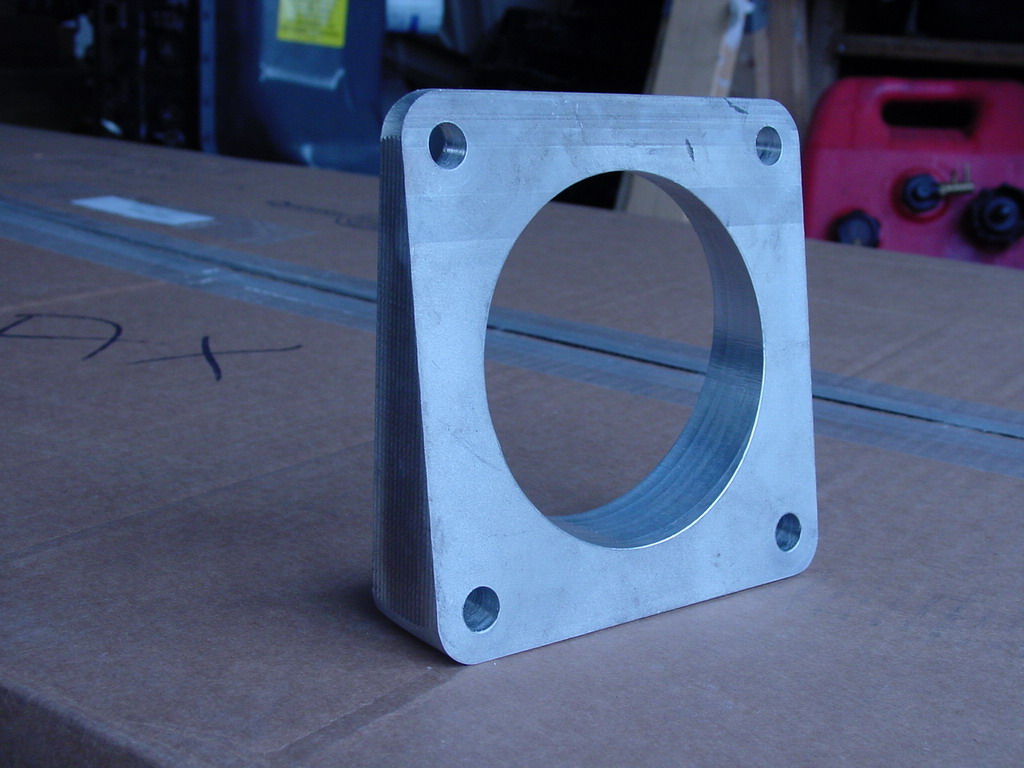

Dave .... just make sure what ever you get that the alignment is right for where the pipes exit the transom. I am not sure if they are standard "Bravo" dimentions.. I had to have some "wedges" made to change the angle of the risers to hit the holes ...But my Gils were originally setup for TRS drives ...The manifolds are gils and pipes are Stainless marine....m
