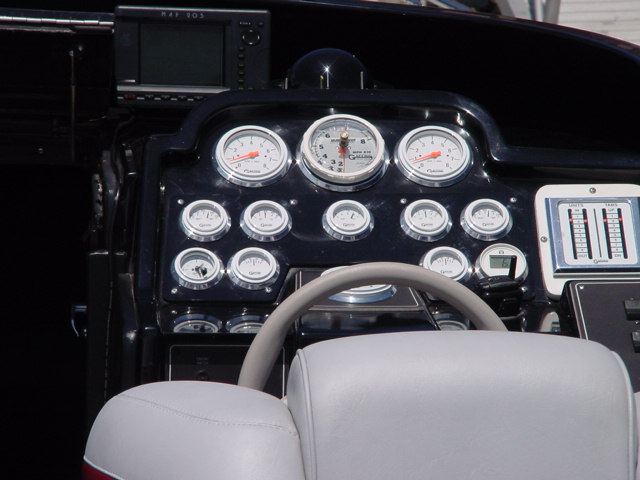

Hi Ron, If you are unhappy you could do what I did and make your own dash. I didnt like the old black VDO's so I spent a couple of dollars buy the gauges you like find a good piece of dash material have it cut using a water jet, have it all done by merc,then realize there needs to be more room on dash area. Heres a pic of mine. I've put myself through all the torture so I can share any suggestions with you. MFB

Ron, You can put in a switch to flip from one engine back to the other. Also you can move your hour meters away to under dash on side panel freeing up some spaces. I put a Syncro 3 1/2" gauge in middle ahead of wheel. Then put depth and clock up on top where hour meters were.
Birddog, Thanks for compliment it was more of a project than it looks.I changed everything up there switches,indicators,controls,wiring harnesses,cables,well you get the point. Definatly gives it a much nicer look. especially at night. Then when I did all that realized I should do all opholestry$$$$$.

Bill, the wiring harnesses were all replaced at the same time I put in new 502EFI's.So the new harnesses were set up for the new gauges. I believe for the gauges and polished bezels, indicators,dash,was around $4500. then I put in new controls another $1100. then all new Gaffrig switches of course everything had to match. It was nice to get away from the square bezels.
Thanks for compliments guys, we need to keep these old birds flying! MFB

Mark, that is a nice-looking job! I took one look at that and said to myself, "Whoa! A Euro gray interior!" It's been a long time since I saw one of those, but it really is sharp!
