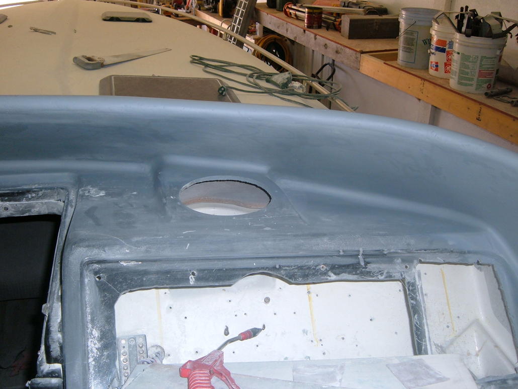

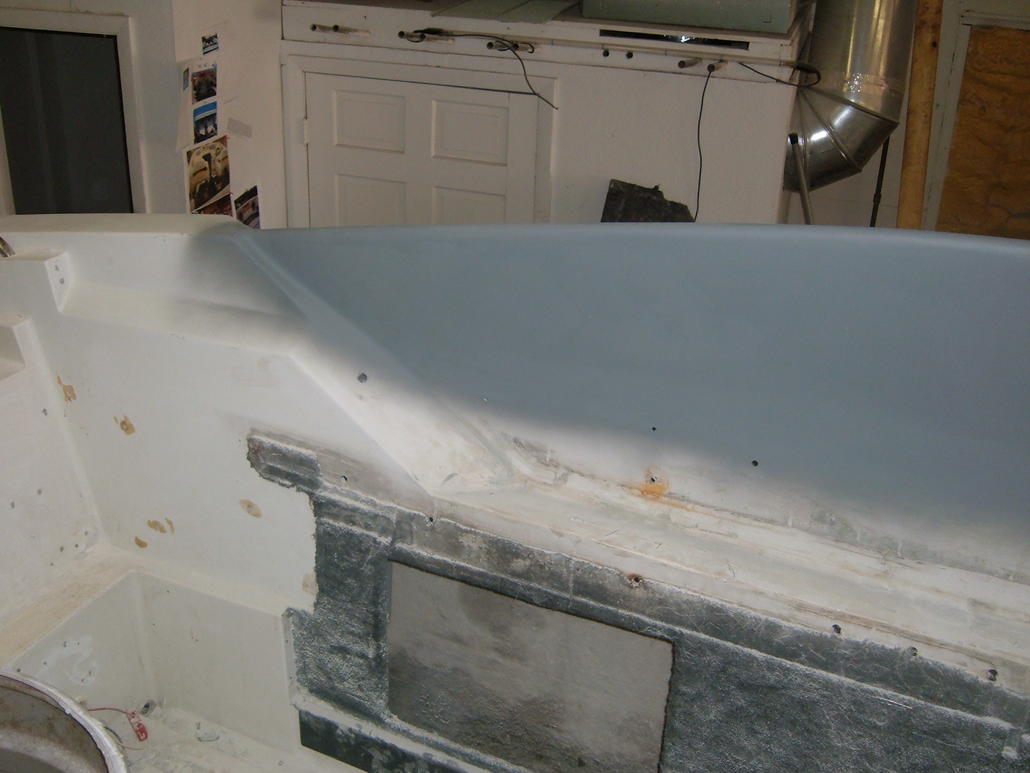

Few more pics. Used spray foam so I had something easy to shape. Worked very well. The fairing is 3 1/2 inches lower in the front than the glass was, but I kept the same height on both sides until just past where the grab bars/supports mount. This way I could reuse all those pieces without any additional work.

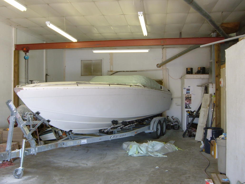

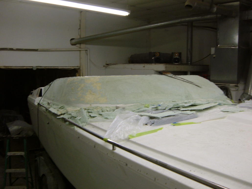

The fairing took me more time than all the rest of the boat combined!

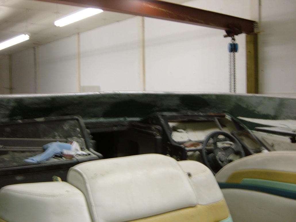

Few more. sorry for the blurry pics. not too great with a camera.

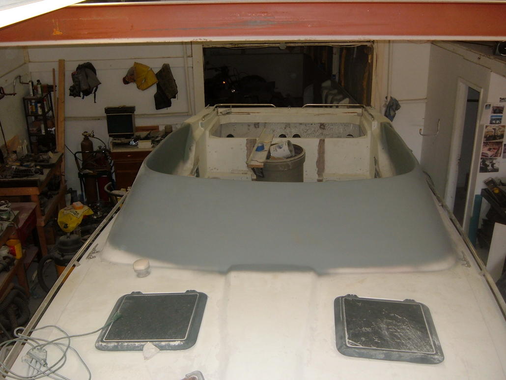

Three layers of glass later and a coat of primer and this is what I ended up with. I didnt have the heart or the energy to take any pics of this step, which happened to take over a month for me to complete.
