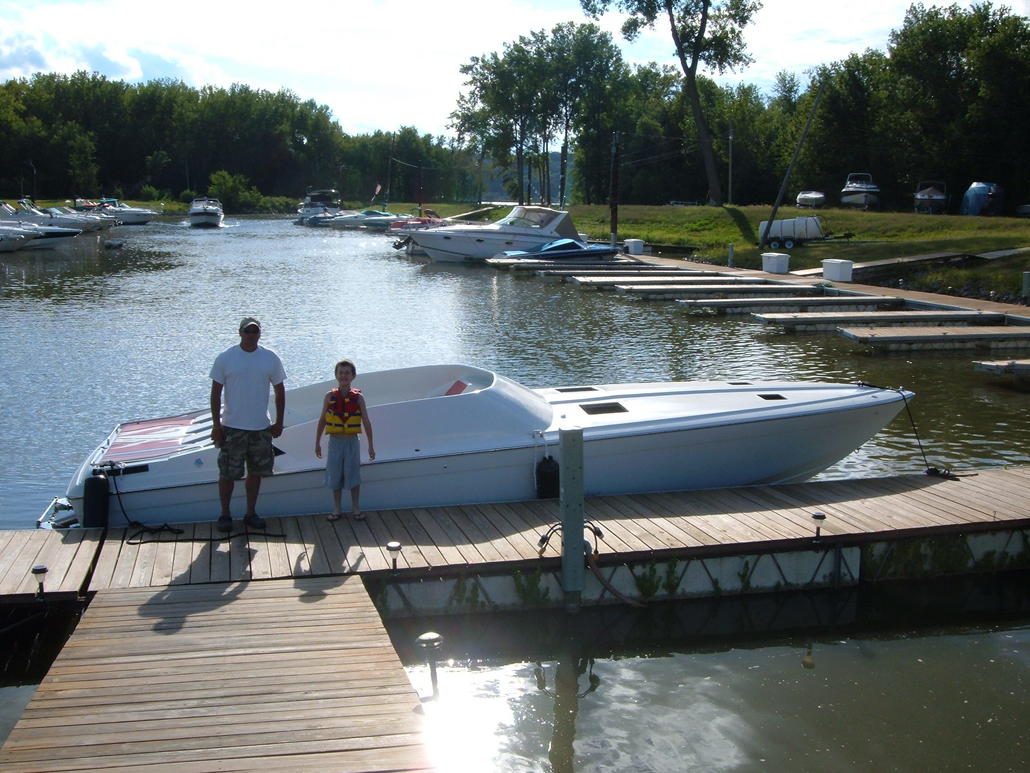

Well, she made her maiden voyage today. Couple small problems, but nothing major. had a neutral safety switch work intermittently, one shifter hooked up backwards (fixed it on the water), and blew a fuse on a tab pump. other than that, performed flawlessly. The boat is seriously underpropped, but due to that was an absolute rocket out of the hole. Top speed 54 at 5000. it would get to that in about 5 sec from a dead stop and wanted to keep on spinning up. Going to have to go up at least one prop size to start and go from there. It rode great and handled excellent. All in all a superb trial run. Couldn't wait for the paint on the bow hatches to dry so we went without.
