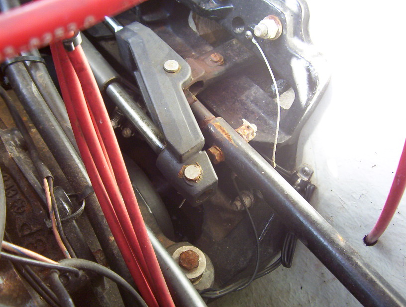

Joined: Aug 2006
Posts: 2,090
From: IAD/FLL
Originally Posted by Live Wire II
I had the gimbil repaired and hydraulic steering installed.
Until you go full hydraulic, you can still have slop in the cable helm. Once that starts to loosen up, the only fix is a new helm. My '91 had slop in the helm but the real kicker was slop in the inner tie bar. It was loose right at the one bolt that holds the bar together.
