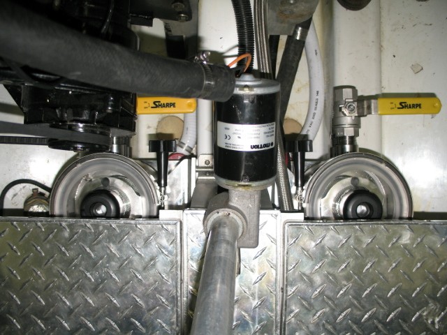

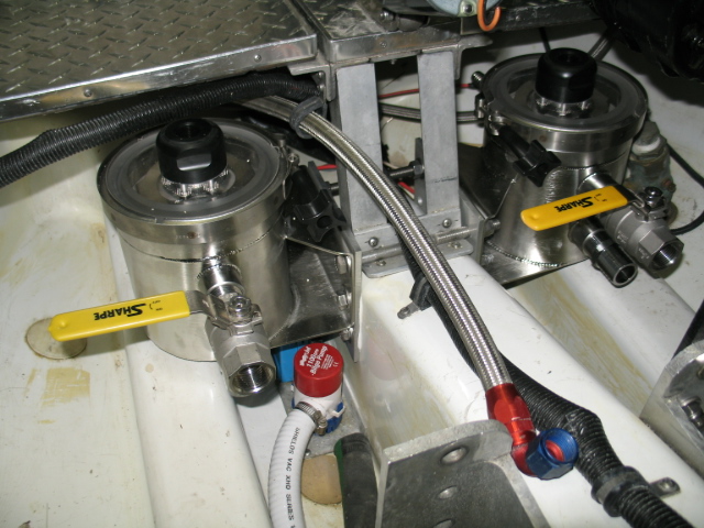

Don't know if this helps you, but this is where I installed strainers on my 382. Same as the factory location. Did it while I had the engines out, otherwise it would have been almost impossible.

The factory strainers are Gil. Here is my 382 as delivered and after I modified them. I fitted them with threaded inlets, installed ball valves, and added an additional fitting below the screen so they can be back-flushed with a hose. (Those are the smaller hoses that you see coming out of the forward/outboard area of each strainer.) I changed the knobs to T-handles as well.
