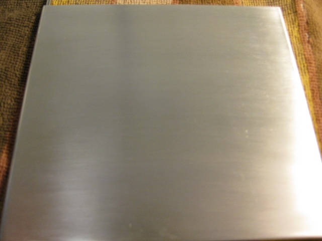

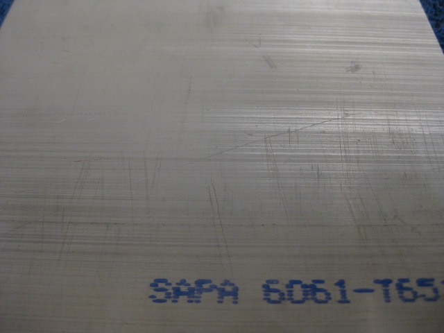

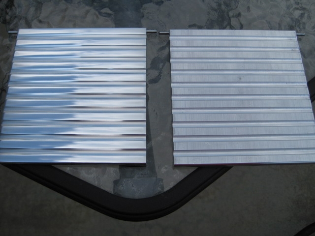

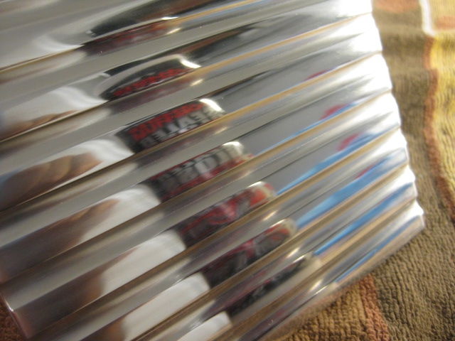

For the last week I have been working on polishing up one of my lids for the step plates. I just did one lid to figure out the best method to get the results I was looking for. I am extremely pleased with how it turned out!
Now I'm sure there are easier ways to do this, but I decided to do everything by hand so there was less chance of screwing up a one-of-a-kind piece of hardware.
These billet pieces appear to be from extruded bar, so there are slight grooves from that process that needed to be sanded out. I started out wet-sanding with 220 grit. This may seem too coarse, but it was needed to get the grooves and machining marks out. It takes quite a bit of elbow grease to get ALL the marks out. Be patient and be sure you have everything out before going to the next finer grit. I used a good desk lamp and some reading glasses. Wash everything and start with a new clean work surface before going to the next grit.
I used the eraser end of a pencil and sandpaper to get into the grooves machined into the top. Worked real nice.
Started with 220, then 400, 600, 800, 1000, 1500, and finally 2000 grit. 3M wet-dry paper is the best I have found and you can get it at most auto parts stores.
The first two pics are of the raw part. The second two pics show what it looked like after the 400 grit.
Attached Thumbnails Step Plates Are Done!!-pic1.jpg   Step Plates Are Done!!-pic2.jpg   Step Plates Are Done!!-pic3.jpg

Thumbs up ...and for the final polish
I did some research to find a really good aluminum polish. What better place to find information on polishing billet aluminum than some biker forums! A lot of guys swore by this stuff called Master Formula Metal Gloss and Sealer Gloss. So I ordered some on-line and it works great. No abrasives and out performed Mothers. They claim the Sealer can last up to a year. I am going to try going a season without a clearcoat and see how it goes.
The finish came out beautiful and matches the Eddie Marine billet handles perfectly!
It will be a while before I get all the other parts done, but I will be sure to post pics of the final install.
Attached Thumbnails Step Plates Are Done!!-pic5.jpg   Step Plates Are Done!!-pic6.jpg   Step Plates Are Done!!-pic7.jpg
