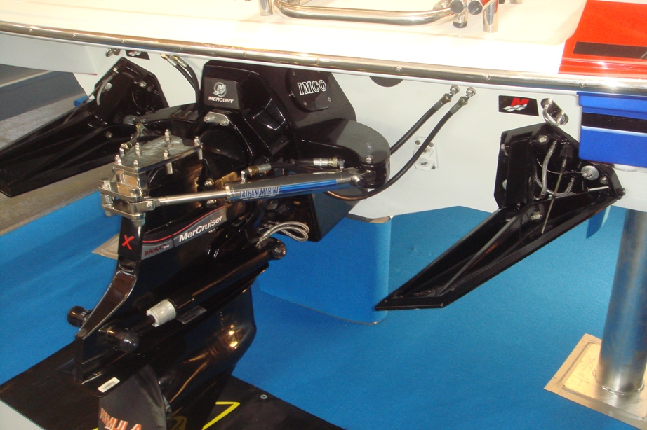

380 Merc racing tabs
they are very fast and perfect for the 271 , but expensive

Power Boat Magazine did an article on the 271 with 280K Planes. Those 380's look really radical. nice.
