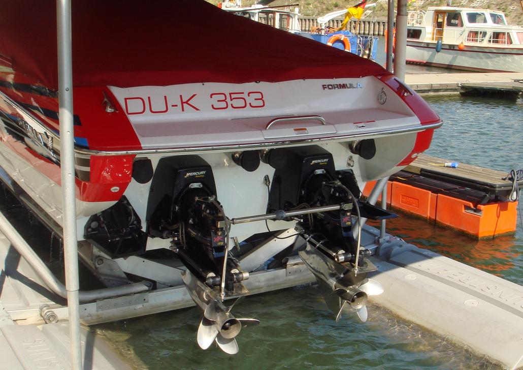

Formula is using Corsa Mufflers for Boats built for Europe
They have no loss in HP and sound nice but not too laud
