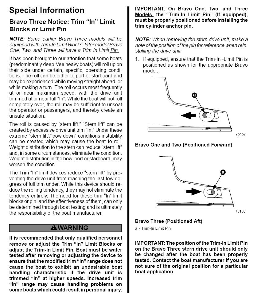

Not sure about your 353, but my 292 arrived from the factory with the trim-in limit block positioned aft. I changed it to allow the drives to tuck in further and it helped the boat plane out a bit quicker. Just don't run at speed with the drives tucked all the way in and turn her hard.
