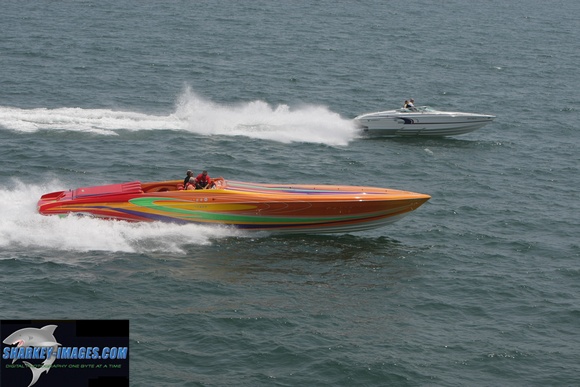

Expensive Date 06-18-2011 11:41 PM
1 Attachment(s)
Attachment 450988
Here is a perfect example of a properly trimmed step bottom boat.I was turning to port a little thats why the boat is leaning but its running on the surface area between the first step and the transom.
