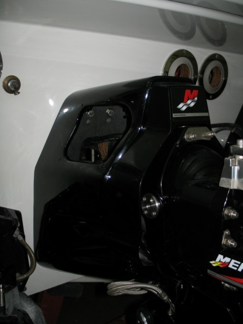

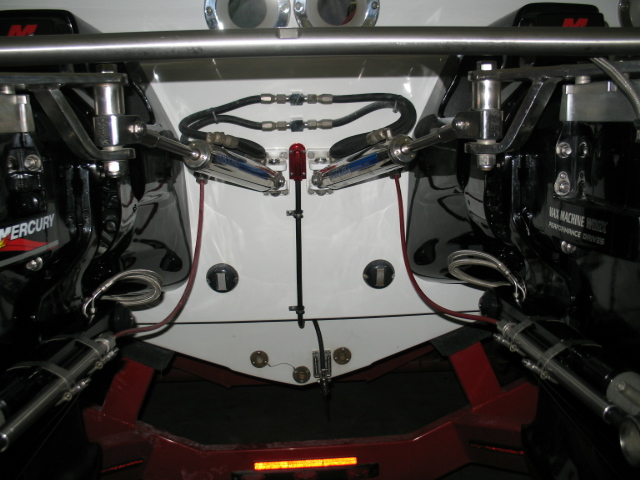

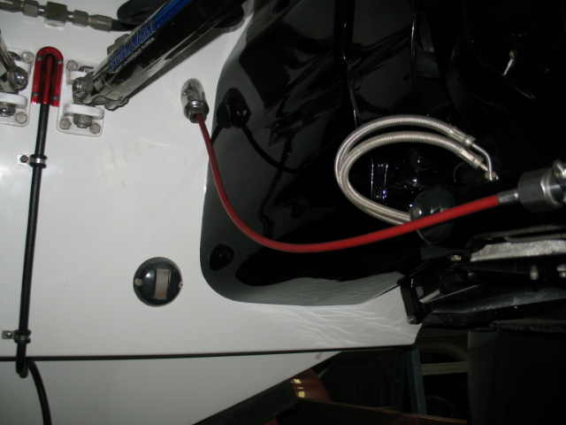

I know Formula did a lot of experimentation to arrive at the optimal X-dimension on the 382. I think one would be wasting a lot of time and money trying to change it from factory specs. I refinished my Stellings a few years ago and reset them to factory height. Hope some of these photos help. You can always check with Formula TAG ... they are always very heplful with techincal questions like this.

I'm willing to bet the transom cutout is the same. Mine are on the center hole of the three for height adjustment. Can't get a measurement for you right now as the boat is in my building in Ohio, but I think it was 3" from the notch to the bottom of the Stelings box.
