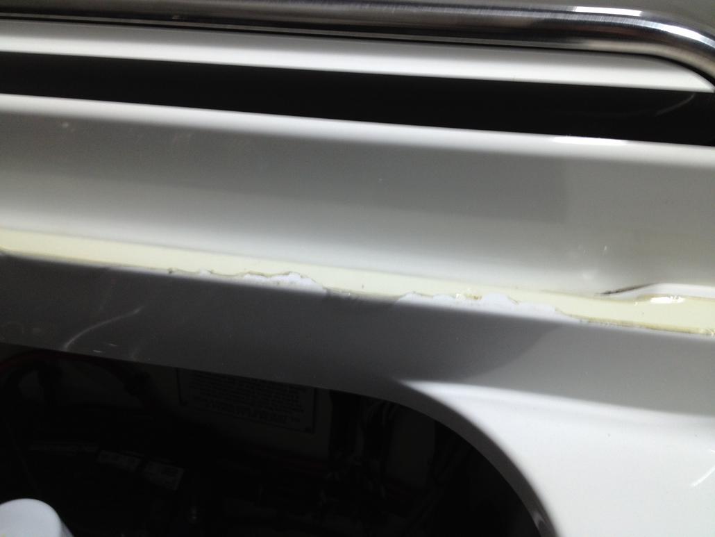

Where can you buy, besides Formula, this protective plastic material that the rear hatch sits on?
Also, what is the best way to get the old material off?

The clear strips I used are made by 3m (paint protection film). You can get it from a bodyshop supply house or look on web. To remove the old you can get a eraser wheel that you put on a drill it will take it off or peel it off by hand and use some general purpose adhesive remover by 3m.

I bought mine from Formula and if I remember correctly, it was like $10 for both sides...
