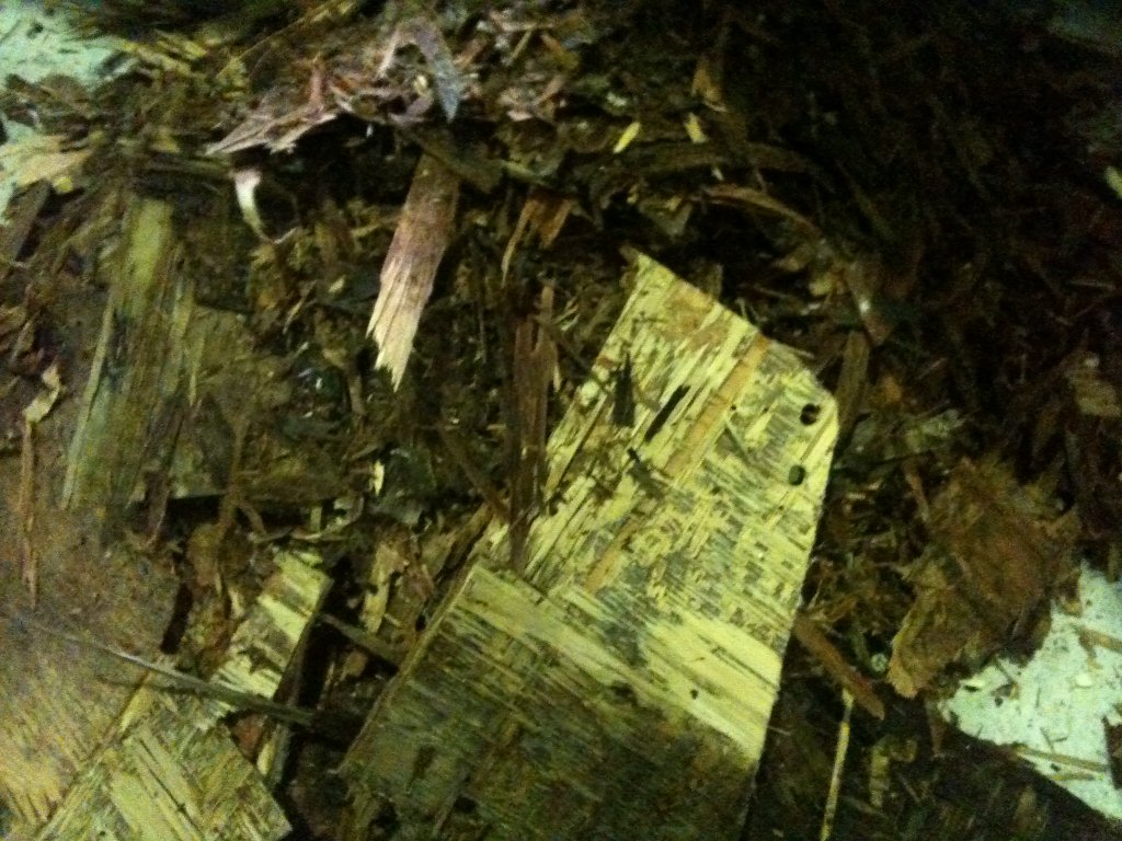

I have rebuild the transom complete rotted out :-( So every thing is out of the boat at the moment, engine and engine hatch. So I do not have the posibilty to measure at the moment.
Pics of rotten wood and newly rebuilt transom
If anyone could measure the hight from the engine mount to the point where the flame arrestor hits the engine hatch it would be great. As shown on the pictures this is the higest
point on this engine.
