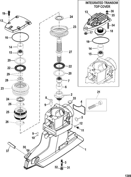

There is what has been refereed to as the "celery stick" at the mounting point of the trim rams to drives.
This can be rotated 180 around to the front of the pin which lets the drives tuck further under. Helped my friends 382 plane faster. Has showers also which i think add to the cavitation out of the hole.
Tabs at about 2 was about all it would like.

# 37... Ok the real name is "Trim Adjustment Insert".
