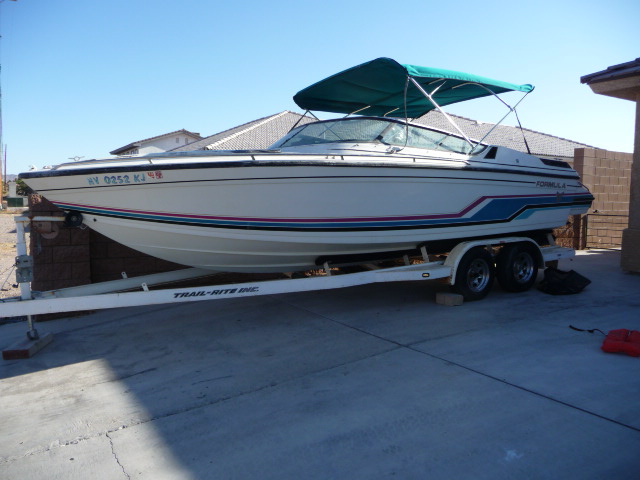

Here is my Big Brother and Little Sister
Attached Thumbnails Has any one installed a generator in a 357 SR1 ???-p1040548.jpg   Has any one installed a generator in a 357 SR1 ???-p1010302.jpg

I'm thinking of the same idea of twin boats. I have the matching 242LS of a 357 SR1 that I could buy. Funny that the graphics are the same Palm Beach graphics you have.
Those pics are exactly what I needed to give me a feel of space. The problem I will have is that this 357 has TRS drives and the engines are about 12" forward of yours. I think that will force me to use some of the space under the back seat in the same manner of the 382 and 353 with gen sets.
What is the smaller boat?
What speeds do you see with your 357?
