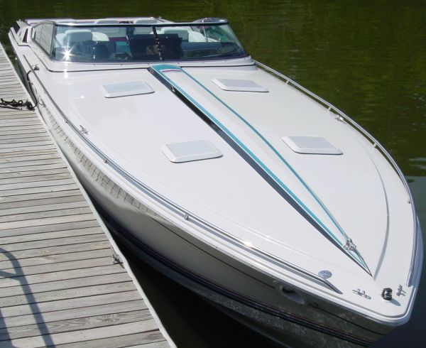

I have mild 540's in my ' 93 357 with Bravo drives.Engines did a little over 600 on a car dyno with dyno headers, I would guess 575 hp with my Eddie marine wet exhaust. The boat likes a 28 pitch Bravo 1 prop best.Best speed I have seen is 72 mph, boat will run 70 on any day.Same motors in my ' 89 311 with Bravos would do 78 any day. Yes the 357 is a heavy tank, but it will crash through big water that would make me slow WAAAAAAY down in the 311 to avoid getting killed. There is no comparison in the rough.I think that you would need at least 700 per side to get that solid 75 mph.
