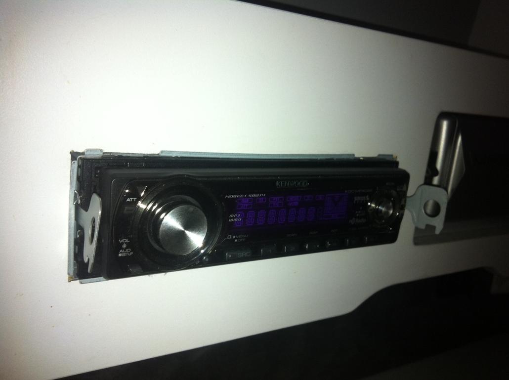

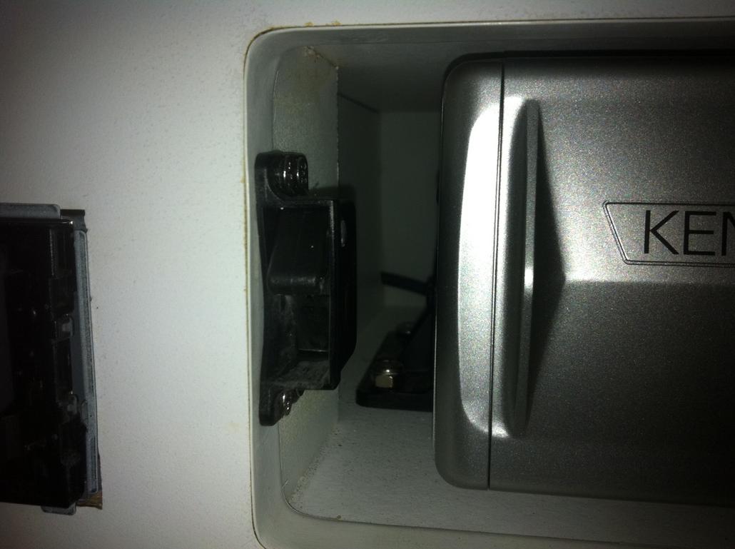

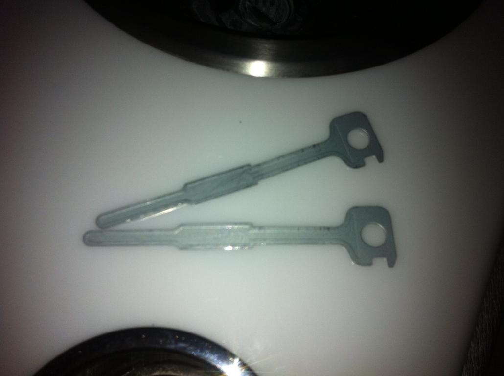

Okay... Upgrading my receiver to a Kenwood KMR-D562BT and amp to a Alpine PDX-F6. I'm not new to mobil audio and have removed plenty of receivers from the mounting sleeve using the extraction keys. I've worked on this one for over an hour and nothing! It doesn't budge, like it may be secured using screws or something. Even tried a long butter knife. Doesn't move. I am calling Formula tomorrow but thought maybe someone out there has run into the same problem.

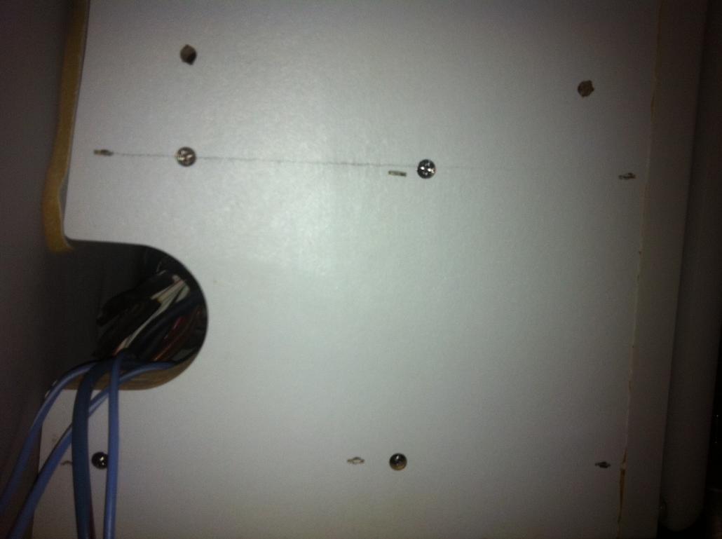

I removed the side upholstered trim piece and the side panel (second pic) is screwed, stapled and probably glued to the cabinet. Looking for some ideas which hopefully don't involve a sawzall or sledge hammer!

If I remember correctly, the keys won't get it out as you have discovered. Since the cage (sleeve as you call it) is mounted in a very flimsy hole Formula used a couple different ways to reenforce the radio. If you can get behind it you may find a strap holding the back of the radio held on with a stud on the back of the head unit or perhaps a couple of screws on the side of the radio.
Report back after you check it out. Once removed, the keys will release it from the cage.

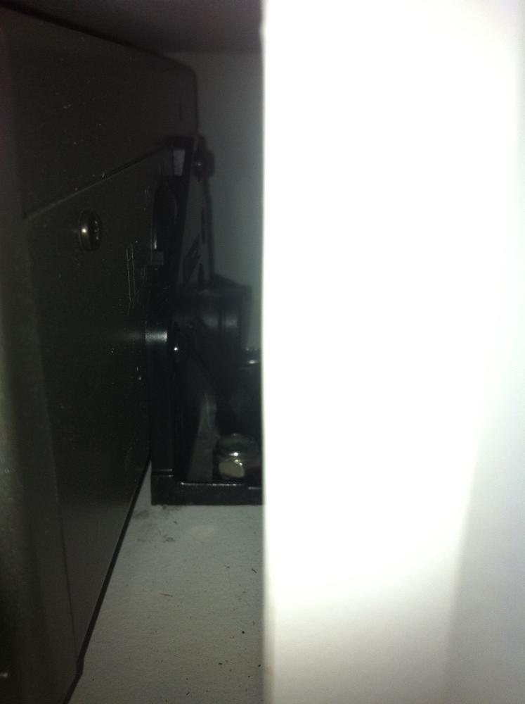

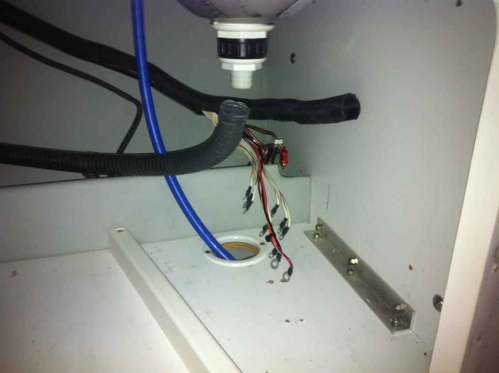

The first pic shows there is a wall between the head unit and changer that goes all the way back. The second pic shows the two front screws to the changer from under the cabinet, but there are also two back screws. I guess these have to be accessed from the back as well. I'm anxious to talk to Formula to hear of a possible solution.
Your boat is a couple years newer, but radio looks pretty much the same and I've had my radio out a number of times with no issues, while looking to see if there was an AUX for a iPod connection. Could it be that there isn't enough play in the wiring behind it? I know I can only pull my radio out so far before the wiring stops me.

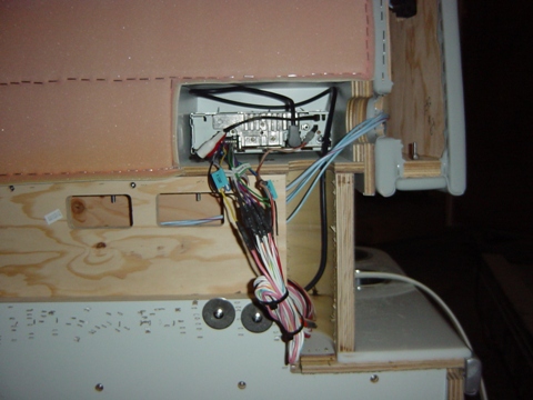

Update - Finally got back to work on this project. Nick at Formula was very helpful and sent me a picture showing the back of the assembly. It showed that in the 292 with a single DIN style receiver there were no other mounting straps (first pic). Like Splitdecision271 said, it could be the wires hanging it up. I used a long screwdriver in the side hole to pull up the clump of wires to give it some slack and another tool to push on the back of the receiver. FINALLY she popped out a bit and I took it from there.

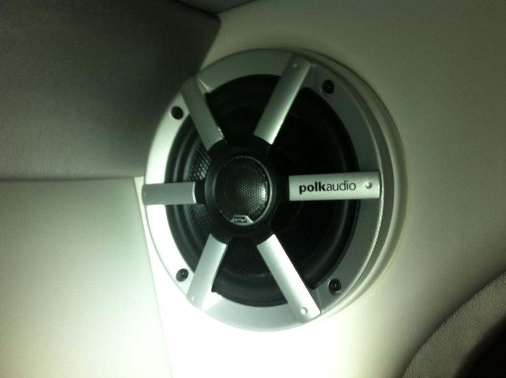

Upgrading the speakers in the cuddy too. Had to space them out for clearance and made some 3/4" thick MDF speaker rings and covered in the white ultra-leather.
