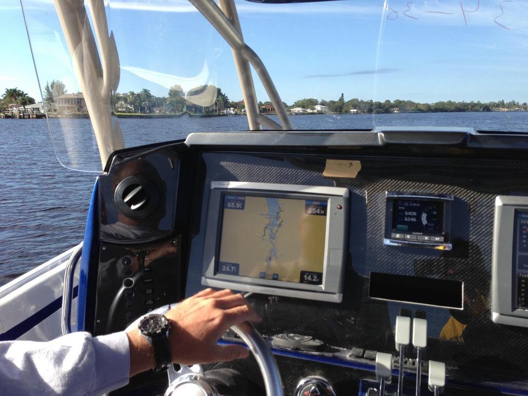

My Nor-Tech 34 CC reportedly weighs in dry at 9K lbs. With twin 300s it runs low 60s with plenty of fuel, factory ran it 65.9 on test run, but we know it had little fuel or extra weight. With a full tanks, 270 gallons of gas, the key to getting it on plane is to have patients, it certainly is not a quick process. I know I'm comparing a boat engineered for outboards to a boat engineered for stern drives, but both boats are similar in size, weight and beam (10 ft).
