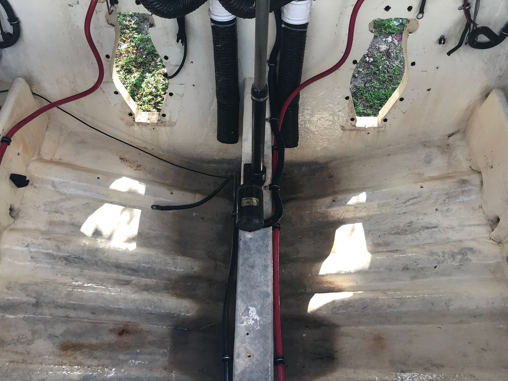

I made the jump for outboards, transom holes closed this Saturday, bracket will be installed Monday and by the end of next week I will be running a pair of Zukes 300. Couldnt deal anymore with upside down maintenance.

Transom sealed

Been talking about doing this to a friend of mines 06 330ss. What is the plan for the space/abandoned engine compartment? Leave as is/storage?
Redneckcustoms13 12-16-2019 12:54 PM
Hot tub
