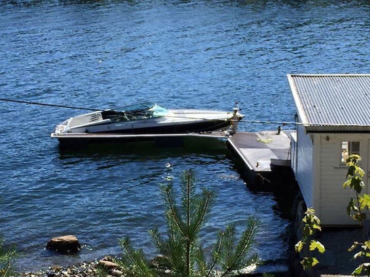

Hi guys
I have a 1993 271 Bravo1 XR 2009 Mercruiser 496 HO 425 Hp bravo1 24 pich prop
Best i have seen on the Gps so far is :
Alone with less then 1/2 tank of gas 60 mph 5000 rpm
3100 rpm 34,5 mph
3600 rpm 40,5 mph
4000 rpm 46 mph
4 people and 1/2 tank of gas 58,5 mph
I am going to try a Mirage 25 + if I can spin 5000 rpm with that maybe I will reach 62 mph
I am very happy with the Bravo1 24 gives a good all over performance
Ciao from Oslo Norway ;-)
