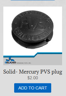

I would get some of these plugs and see if closing off those vent holes significantly reduces slip. I believe they will fit your props. Brett at BBlades will know. Good luck Kai! You will be much happier with how the boat runs once you get the slip reduced.
http://bblades.com/product-category/...es/vent-plugs/
