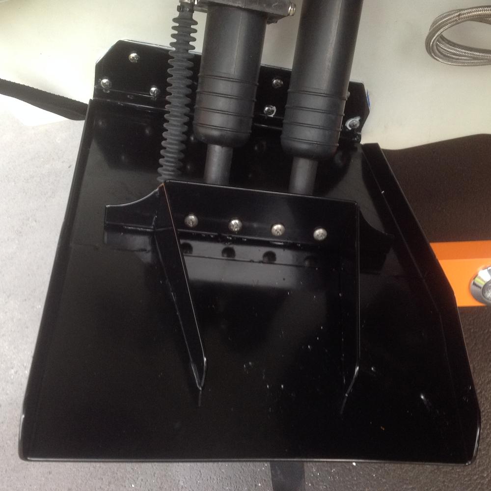

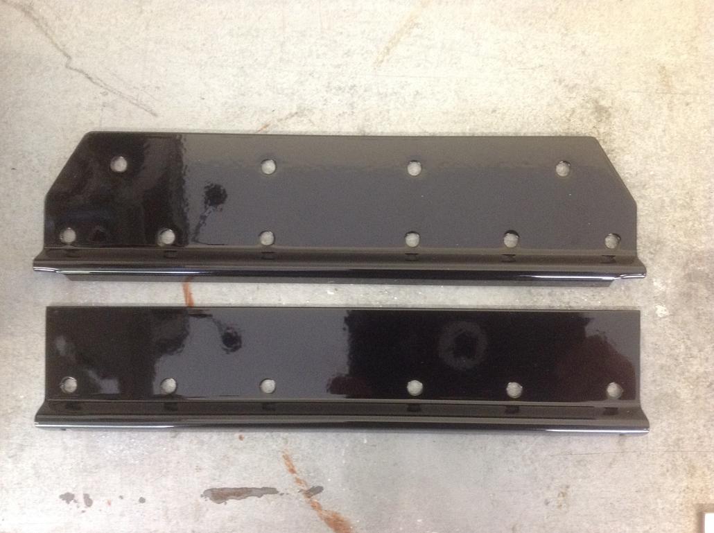

The new backing plates are here, and the tabs are out to get welded. Total cost will be under $250. I will be able to see if the tabs really make the difference, and then decide if further upgrades are needed. Here is a shot of the new plates. I will install them with some 4200 on the plates and screws...they should hold fine. I will post a picture when the tabs are done and ready to go on the boat. This should happen next week. [ATTACH=CONFIG]558979[/ATTACH]

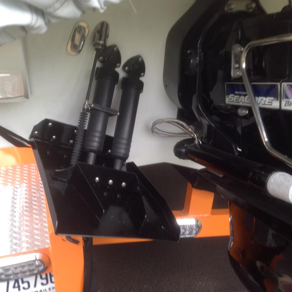

Tabs are done. I will probably polish them for a little bling. Added 4.5" to them. Wont be on for this weekend, but soon. More to come.[ATTACH=CONFIG]558999[/ATTACH]

Tabs are now done. Double row screws, all joints have 4200 to help keep them in place. They look good. Hope to be able to try them out in a week. Local fab shop did a nice job extending and reinforcing them. [ATTACH=CONFIG]559478[/ATTACH][ATTACH=CONFIG]559479[/ATTACH]
