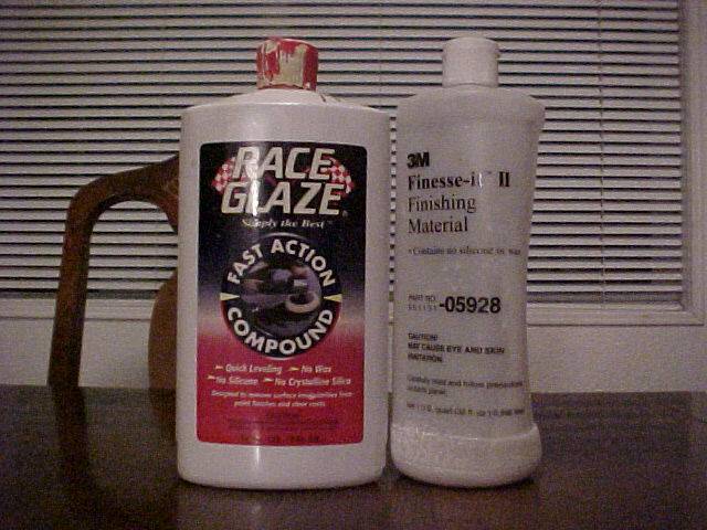

Old 10-08-2002 | 02:55 AM
Posts: 21
From: Cottonwood, California
Default Rubbing out
We first washed the boat, then started rubbing ou with Race Glaze using a Snap-on buffer set at 1500 rpm. After we had rubbed the complete boat with the Race Glaze compound we polished with 3M Finesse-it finishing material at 2000 rpm. The key is to keep your buffing pads clean. Good luck
