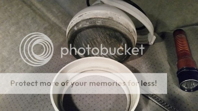

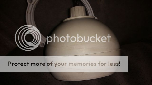

Does this sealed beam light come out of this plastic housing?

I believe you have to replace the whole thing. I know some guys have replaced them with LEDs.

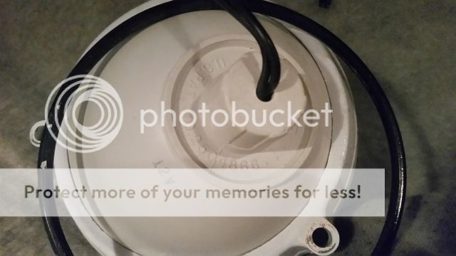

Bolt in or have to replace the housing on the hull as well?

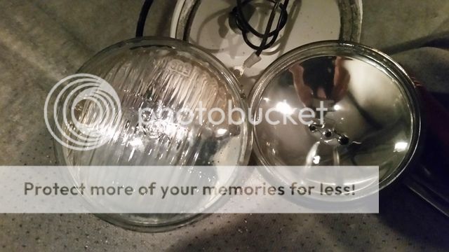

Figured it couldn't hurt so I decided to get them apart.

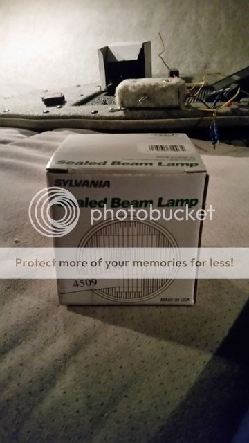

I played around at oriellys ctossing part numbers and played with google to find a 4.5" 100w spot rather than flood. Sylvania part# 4509. $12 each and they had 18 at rhe warehouse just a few miles down the street. Returned home poked that one back together. Did the same to the other side.
Original flood on left new spot on right.
