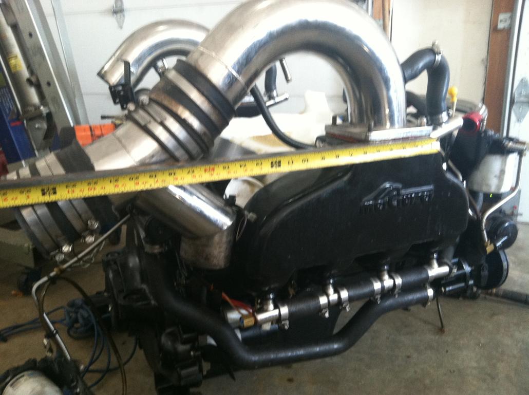

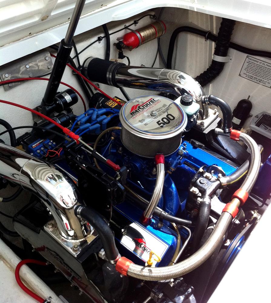

Iīm going to buy new exhaust for my 271 fastech (thinking of GIL-style) and I need to know if 271 have standard or +3 in risers? I donīt have acces to the boat now so canīt measure the hight of the original exhaust holes in the stern. My new engine is hp500, previous had standard 496 mag. Many thanks for input.

HP500 came with "short risers" and then later "tall risers" because of reversion problems. Two pictures here show the difference, tall risers would be the preferred setup. My HP500 was a 1997 had the shorts, I then replaced with tall on the next motor rebuild. So it depends on the year of HP500 what is has on it.
