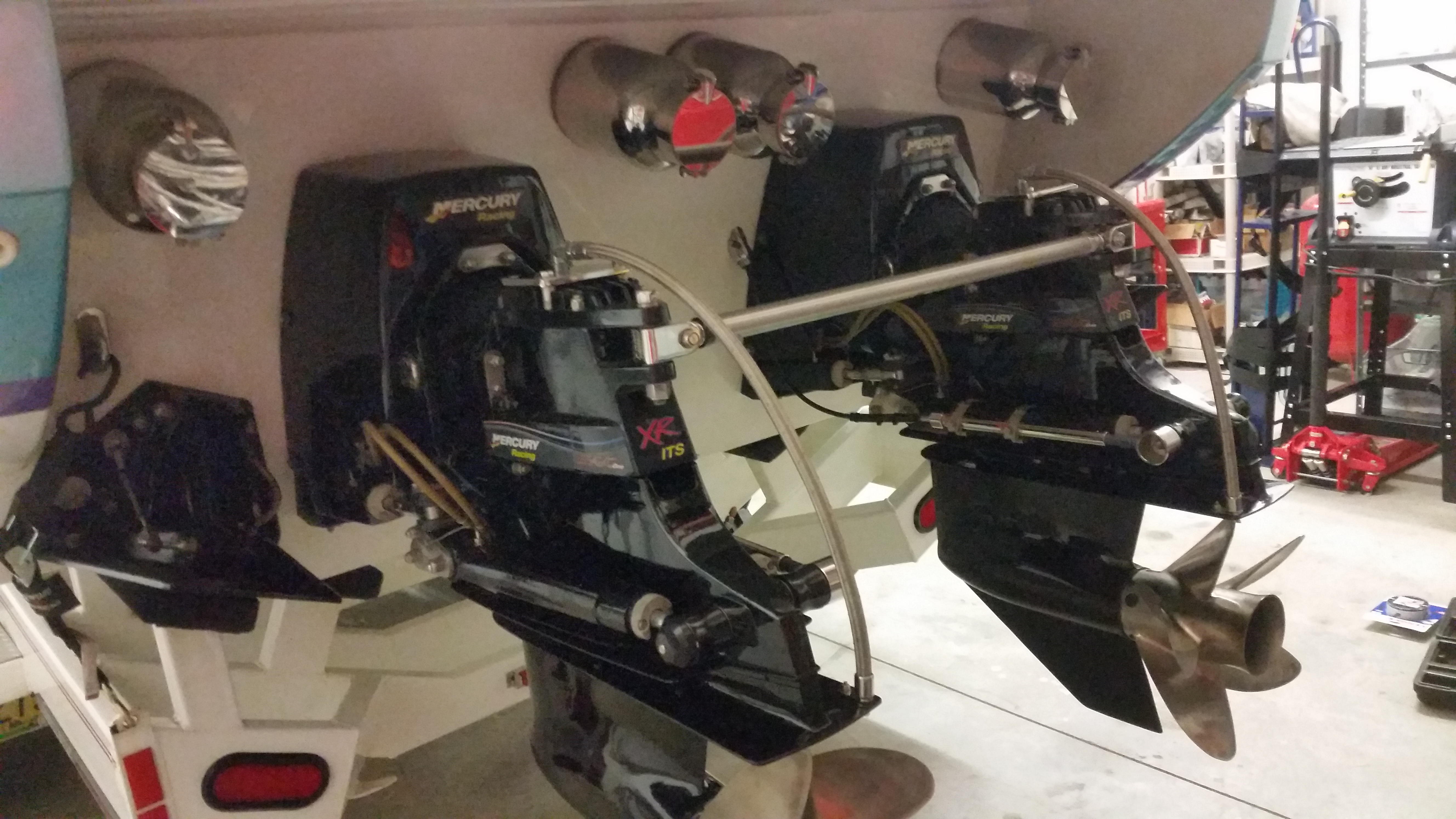

We had an 05 353 525s with ITS. There was an 08 353 525 boat without boxes in our local club. Side by side I was consistently 4-5 mph faster. The real speed difference began to show from 60mph on up. Could there have been other variables? Im sure but when I was shopping 353s I liked the way the boat ran with the boxes vs without. It seemed to carry the hull better with ITS. Also, Im not 100%, but wasnt the X raised around 03 on all 353 production.
