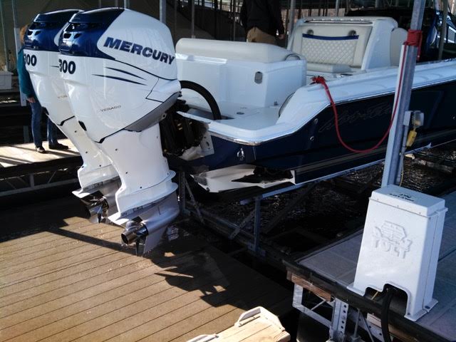

I have an 8' long platform attached to the back of my lift. I use it all the time. There are cheaper ways to flush your engines, but the platform allows me to easily clean and wax the transom, same for the engines (Verados). I also use it for engine and drive oil changes. If you are looking at it for more than just flushing the engines, it is priceless.
That's the way I am leaning. I could change props, drive services, clean and wax all the transom equipment. I am going to have the lift guy do a more detailed quote. The service platform would be a two foot wide and approx' 11' long suspended from the aluminum walkboards on either side of the boat. From the design he is talking about, there would be some movement of this service platform while its being used.

2 feet wide is pretty slim. Mine is the width of the slip, 12 feet, and 8 feet out the back of the boat. Plenty of room to work with engines down, or tilted up without wondering when I'm going to fall in the drink. There have been plenty of times that I dropped a gasket, or an oil or lower unit drain plug that I was glad I had the extra area for it to roll around and not go in the water.
