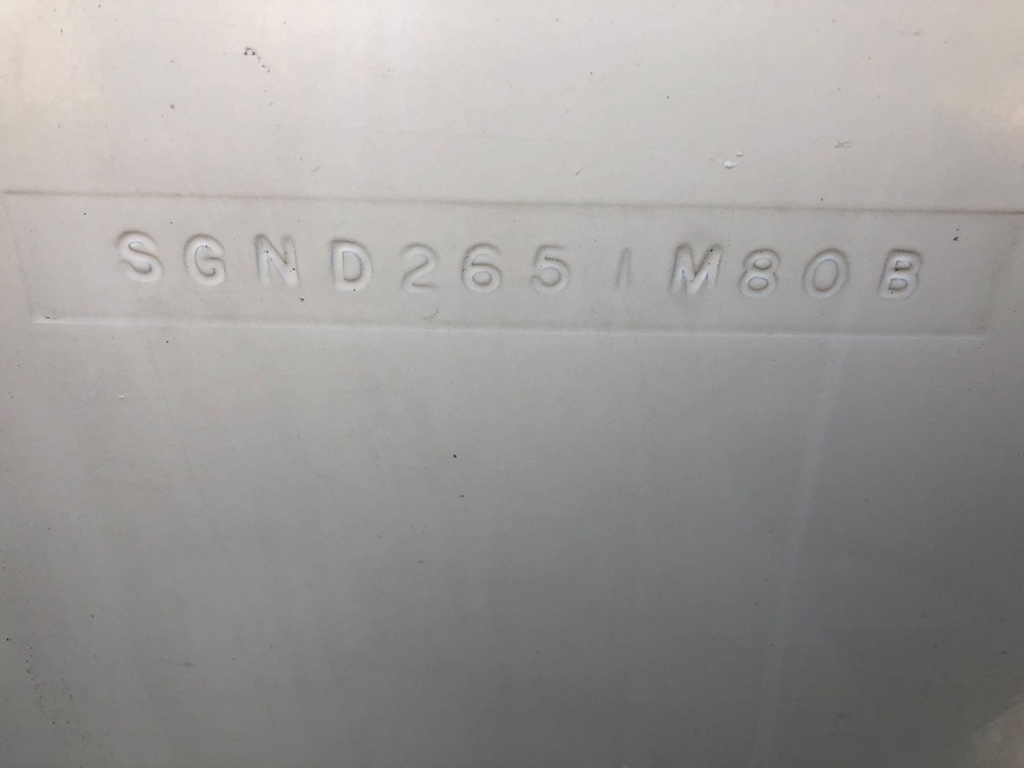

ok, went and checked out the boat, it’s a 23’3 foot hull and 25 overall with the swim platform. Engine was replaced three years ago and the drive was rebuilt 10 years ago and serviced by a local marina every year before hitting the water.
it needs a new headliner in the cuddy and new captains chairs and updated upholstery in the cuddy and really everywhere but it’s not in bad shape just original. Needs a new morning cover and always stored inside during winter and properly winterized by the same local marina.
Here is the HIN

Pretty sure your looking at a formula 233 interceptor.
https://www.formulaboats.com/wp-cont...a-Brochure.pdf

The boat you are looking at is not a 255. I had a 255 for 6: years and it measured 25'-5" at the centerline and 27'-6" with the swim platform.

Thanks for all the help and replies, yes the boat turned out to be a 23’ and 25 with the swim platform. It’s was a single 260hp 350 and alpha drive. I decided it wasn’t what I was looking for so I passed on it. Probably a decent boat for the 4K asking price.
