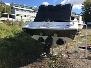

Well guys I know the stepped hull should gain some speed and be more efficient then the straight V bottom. Thought it depend how the hull is stepped
the Formula 271 Fastech is stepped very conservative and have only one step. I have read a lot about the 271 SR and 271 Ftech when it come sto speed
Most Sr1 with 496 Ho or 502 does 58 - 60 mph the 271 Tech the must test results says 63 mph … aprox 3 mph in favor of the Fastech . All GPS speeds
I still have my 1992 271 SR1 with 496 HO and reached my goal of 63 mph GPS actually 63,6 mph … Which I think is one of the best veryfied speedresult I have
been able to find with this set up ;-) My advantage is that the drive is aprox 1 inch higer than original (raised it when fixed the a rotten transom) disadvantage XR Drive
harder to run then a bravo 1 or bravo1x ...
63,6 mph Bravo1 XR Mirage 23+
61 mph Bravo1 XR Bravo1 24
62,2 mph Bravo1 X Bravo1 24 (Had a drive failure on the XR replaced it with new Bravo1 X drive) gained 1,2 mph
I am really looking forward to test the boat with the new Xdrive with the Mirage 23+ next season, maybe it is some speed to gain
