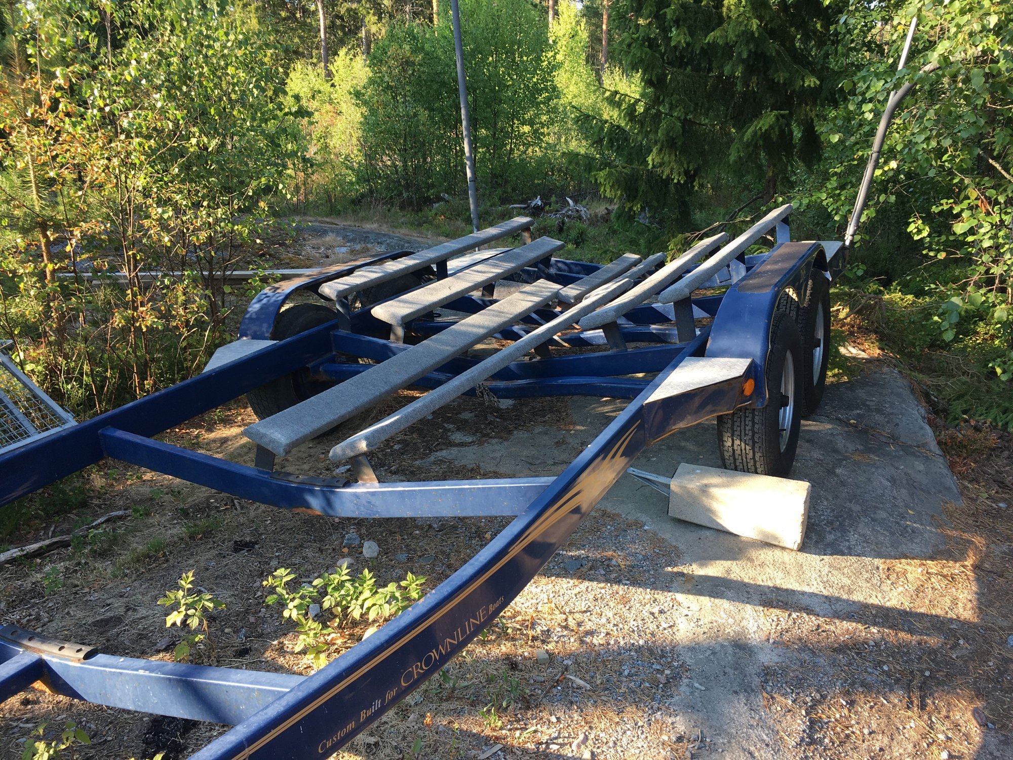

anyone know the hull angle on a 271 fastech? I'm modifying my trailer and the boat is on the water so hard to measure. If anyone have a custom built trailer for a 271 fastech please send me a pic or post here.
I have bought a trailer for a Crownline that I'm rebuilding to fit my fastech.

Considering every bracket is welded on that trailer, I would set the boat on it and take some measurements before I started cutting and re welding things. You may get lucky and it only need minor modifications.

Did the same thing with a myco trailer. You need to set the boat on the trailer. Then get some boat stands and support the boat slightly above the trailer and cut off the old supports and Fabricate new stands and weld them on. Jeff wurl
