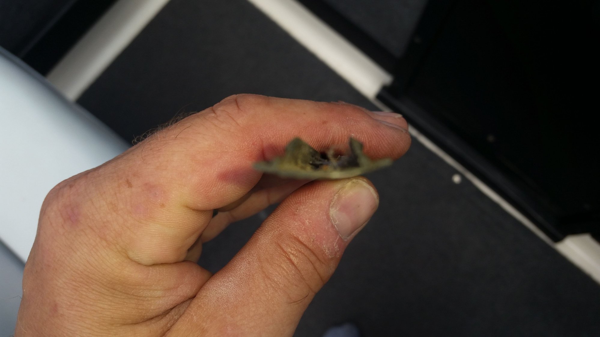

Looking for the trim that covers the wires in the windshield frame. Hard plastic and it snaps into a 1/2" groove.

Good luck with finding windshield bits. I have been searching for plastic trim for my Water Bonnet windshield since 2012. You may have luck at a boat salvage yard. I have a small piece that I have mailed all over the country in my search.

i removed the useless wiper motor. It was directly in my line of site while sitting. Now I have a gap where the motor was. Also, it fits pretty loose. Wouldn’t mind about a dozen feet of new stuff if I can find it.

That’s a piece of unobtainium. I’ve been looking for about 20 feet of it.
A workaround is to use black silicone to fill channel. Clean the channel to remove dirt and grease, and then tape off both sides of the channel with painter’s tape. Apply the silicone, and then smooth it out onto the tape with a wet body filler spreader. Carefully pull the tape before it skins over and the job is done.

I think that’s an option on the newer windshields, but the older Formula windshields use a cover that clips onto a rail that’s in the center of the frame. I had that same idea myself.

It may work then, but the pic shown was the same piece that came out of mine. I couldn’t find anything that would fit.
