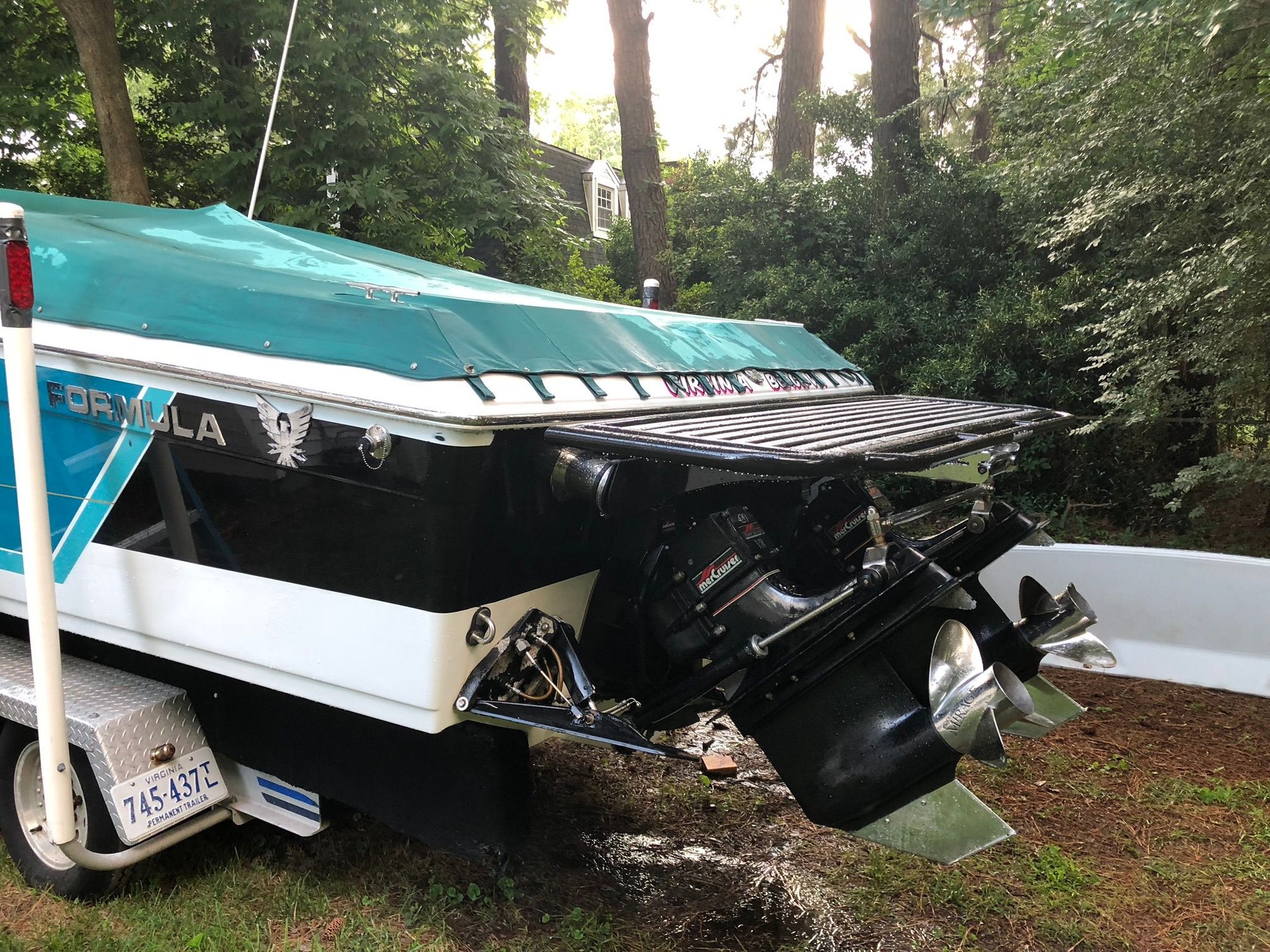

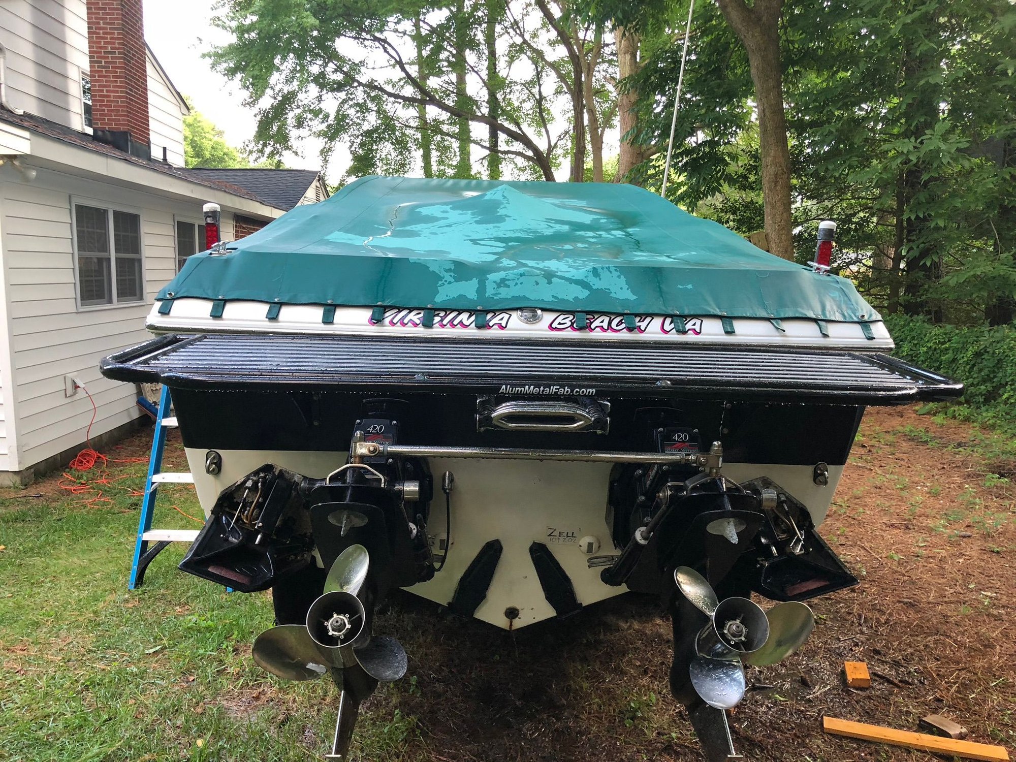

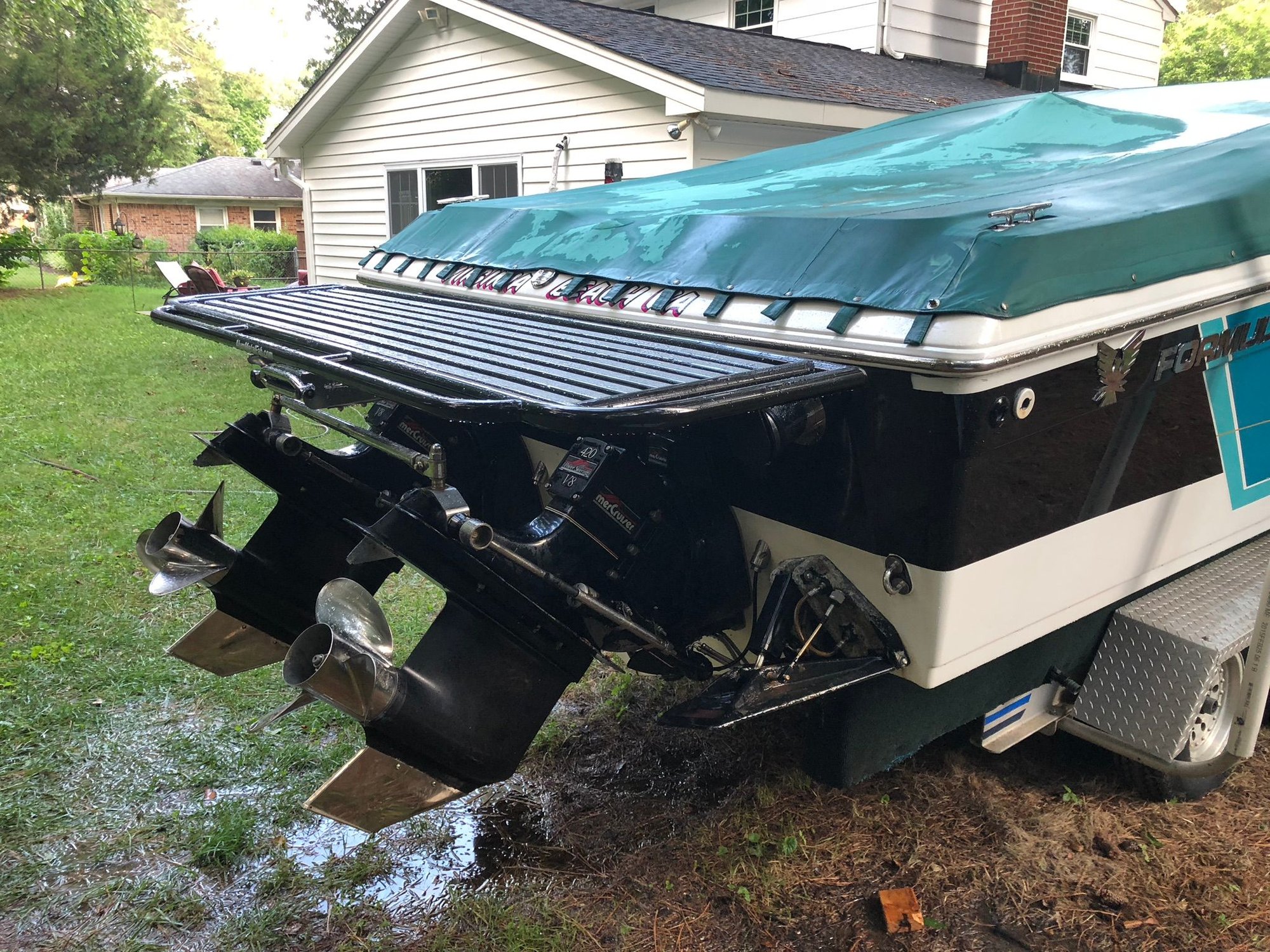

I went with black on mine but that was because I was keeping the color in line with the transom. Others have used an accent color... Josh aka Distant Thunder, matched his to the magenta that’s part of the Palm Beach paint scheme. It really popped!
Black would tie in nicely with your black stripe.
No matter which way you go, get the platform powered coated. The finish will last a long time.
One more thing... our transoms are curved toward the bow at the outer edges. A typical Baja platform may not fit without really putting stress on the platform and/or transom. The one I used had brackets in between the exhaust tips.

With exception to the two bottom trailer u-bolts, I filled all of the holes on my transom with dowels dipped in resin, then used a ‘glass filler to finish it. I had the whole thing done in about two days including paint (easy with black).
When attaching the platform, I used 4200 just around the bolts as they went into the transom. I had the platform supported with straps spacing it out away from the transom so it was t too hard getting the sealant on the bolts. You want the sealant between the platform and the transom.
On the inside I applied 4200 to the bolts coming through, and then sandwiched it in using the backing plates that came with the platform.
All in all I think I spent about three hours getting the platform on the boat... by myself.

One last note... I was using fast cure 4200 (I wanted to be able to use the boat soon after) but let it cure for a week before carefully taking a razor knife to the areas where the sealant squished out. I didn’t do the insides, but will when I have the port engine out to replace the trans (hopefully in a few weeks... been lazy).
