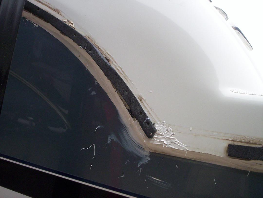

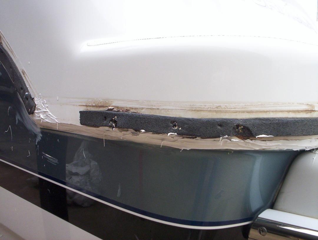

Next was clean off excess bonding sealant on the exposed hull, then make nice straight lines and clean up. Next reinstall rub rail and SS insert.
DONE and no more seperation hull to deck and no more water leaks. The water leaks thru the hull to deck seperation was bad. .
After the repair --- still to this day never had one come back yet

Looks good. How is fastened on those model years? How is it on my 1988? Thanks
