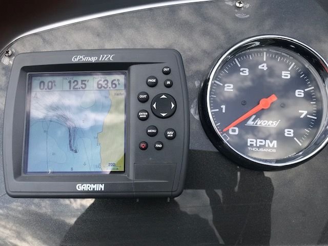

I have a 271 SR1 with a 2009 496 HO aprox 250 hours, doing 63,6 mph (gps) this was with my old XR drive (installed new Bravo1 X drive last season)

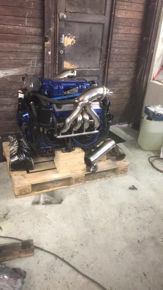

The engine before the rebuild and upgrade
Hi
Thank you for replying
With my current set up, I am running a Bravo1 24 best overall performance, 62 mph top end. Its my 3 blade Mirage plus 23`who
did the 63,6 mph top end speed. I hope if I buy this 500 EFI I should be able to spin Bravo1 26` and a Mirage plus 25`,
if I can not reach 70 mph I will be disapointed
BR
Rune
Monaco20 is offline
