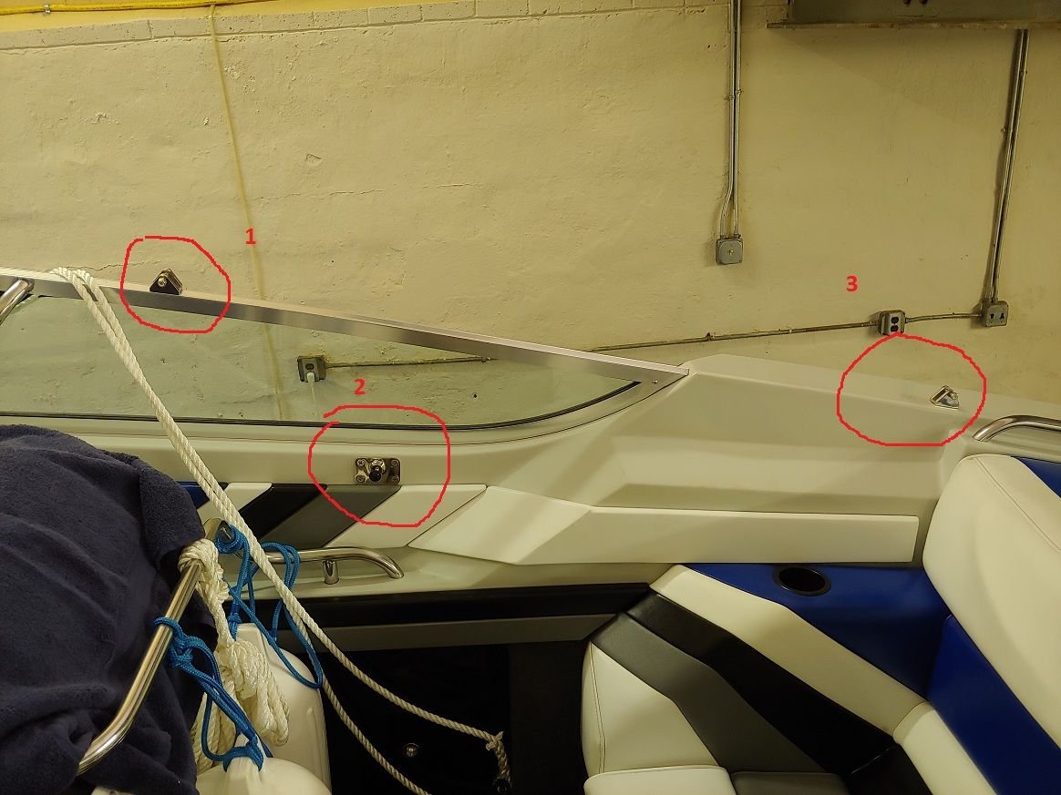

I hope this is not too complicated. I got two tops with my F311 SR-1. The boat has (what looks like to me) three "mounting points" on each gunnel/side
windscreen (picture below). I have labeled the mounting points from front to back as 1, 2,and 3. There are also two eyelets at the top of the front windscreen.

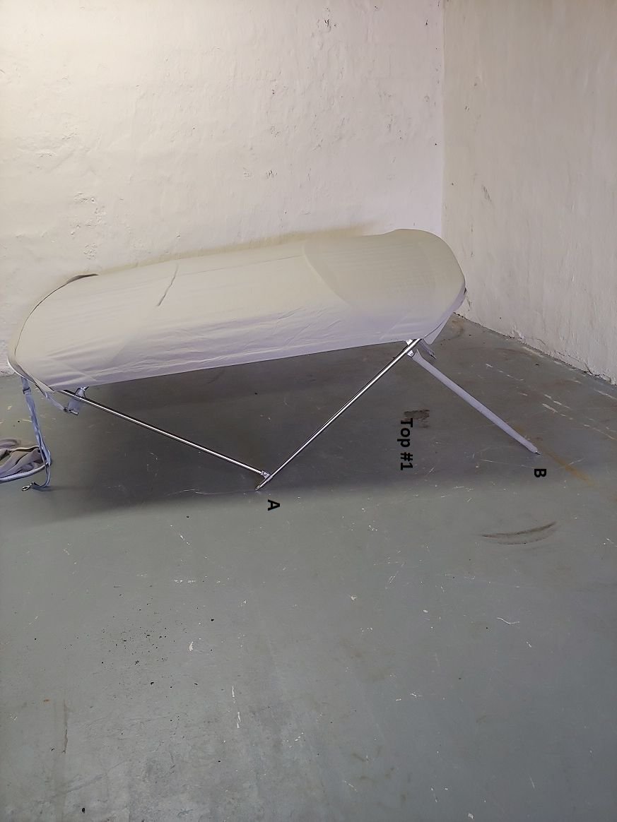

Top #1: What is the actual/formal name (bimini, anchor, etc...) and where do posts (labeled A and B) go...I suspect it goes A1 and 3B, and the nylon straps go to the front windscreen. AGREED? It seems like a lot of weight/stress on the point 1 (sidewindscreen).

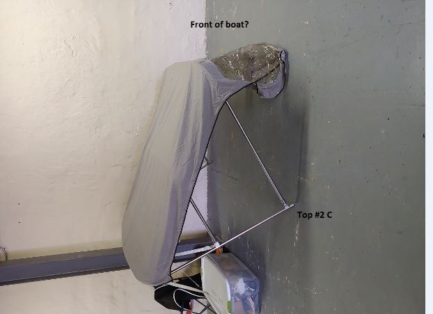

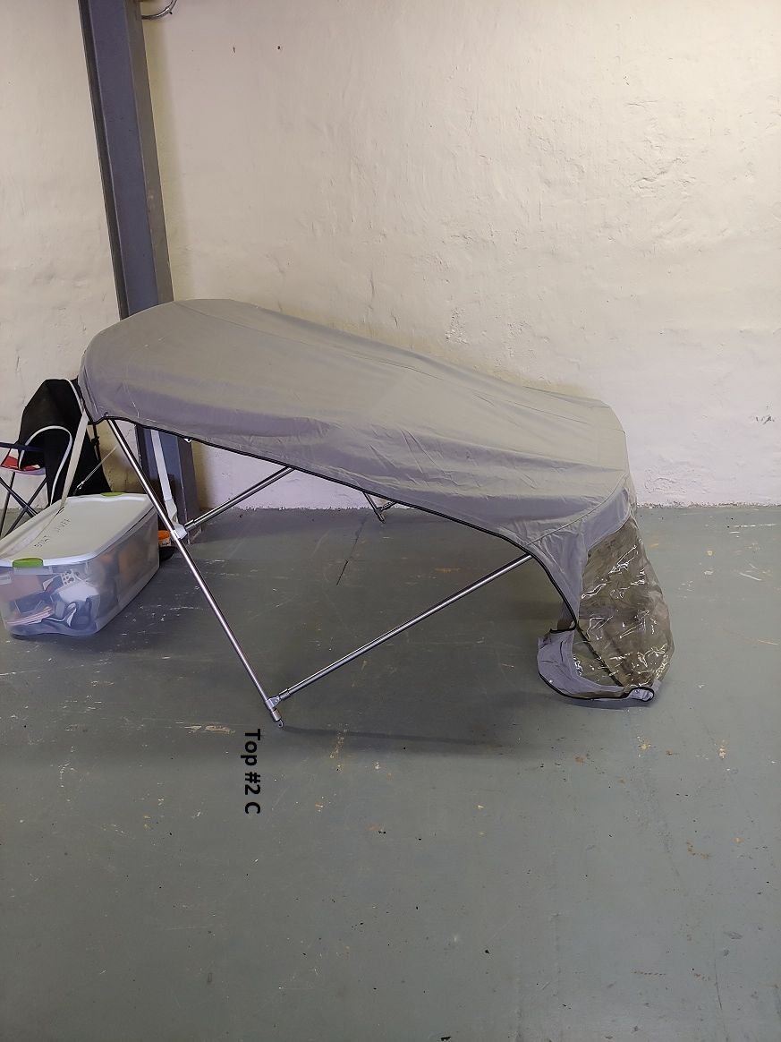

Top #2: What is the actual/formal name (bimini, anchor, etc...) and where does post "C"...I suspect it goes C2, and the nylon straps go to the front windscreen (clear plastic towards the aft of the boat. AGREED?

Top 1 is the original formula “Bimini” top. They came with 4 bows. It mounts on top of windshield frame with the poles going to the aft just by the sun pad. Usually the straps are attached to eyes that are located on the top deck in front of the windshield or to the windshield itself.
I have that same unit on my boat. It’s is a great... large and covers a lot of area. I have kept it closed when hauling across the lake at 60. But keep it open when crushing 35 ish. Works very well and the frame and all supports well.
That other top, 2, looks like an aftermarket Bimini. Would mount on the inside lower bracket. Because it has the plastic windscreen, that attaches above window, then usually has straps or poles that would go to a point in the back toward the suN pad.
Use the original formula one. I even trailer with it in upright position.

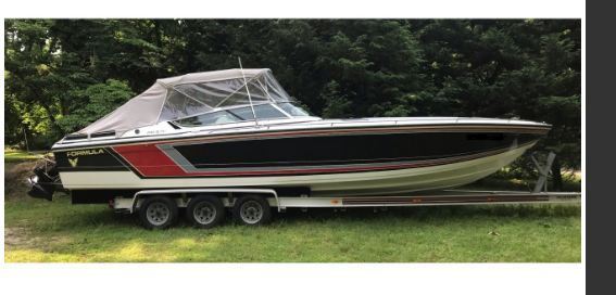

Okay...I see how the canvas/clear plastic looks in this picture:
But my front windscreen does not have attachment grommets...are they add-onable...can you just add receiver snaps to the windscreen trim?
